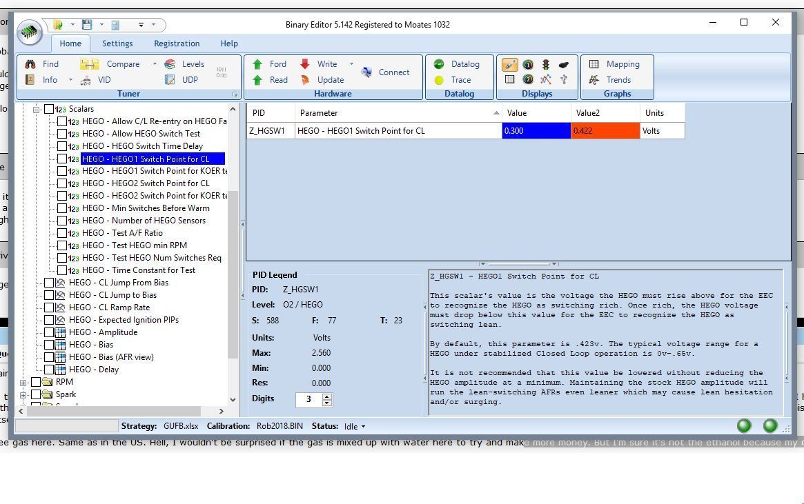

i put a new o2 sensor on one side of my rustang and left the 100k mile sensor on the other side. below you can see how differently they perform. in my case factory calibration is as long as they switch from lean to rich once every 60 seconds, it is considered working. you can see in the graph below though that the new sensor switches from lean to rich 10x where the old o2 only switched once. it needs to cross a set value of .3v -.5v range for the computer to see it as functioning. so the computer says that old low lethargic line is fine. my logic is a bit updated, so if one side fails to switch within 15 seconds, the other o2 is used to calculate fuel trims on both sides.
...from another post i wrote as it's a PITA to load the datalog, filter out the temps under 180, make a custom chart, etc etc. -the yellow line is a bit washed out so you might need to squint a little.
just showing how a lazy sensor looks, not saying it's your issue. i'd blame the snow tires, check the air filter, etc. but i make signs, i'm not a mechanic so just my 2¢
