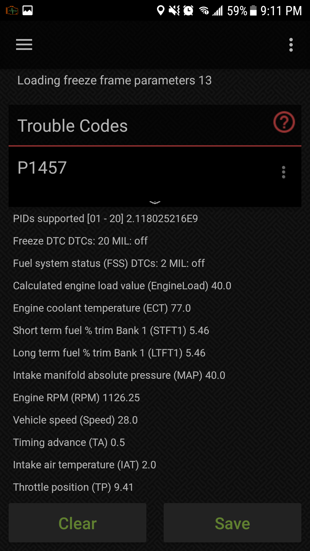

Hi, I have a 2005 Honda Civic LX 4dr Automatic (same as the OP had). I have the same code as well P1457 with about 110k miles on the car. The code has been on since the beginning of this year but emissions is due in about a month and I need to get it cleared and fixed. I have owned the car since 10k.
Do you guys recommend to get genuine honda parts or would aftermarket ones be good and last long as well? If I get the parts from rockauto, what would I get? Vapor Canister, Vapor Canister Vent Valve, and the two screws? (http://www.rockauto.com/en/catalog/h...ust+&+emission)
and how hard is it to do this yourself? I don't really work on cars much but I am a DIY guy. I plan on either getting it done or doing it myself depending on time.
Would appreciate any feedback and assistance. Thanks so much!

it is a pretty simple job,
jack the rear of the car up if you want to make it easier,
remove the entire cannister with the valve attached, it makes things much easier,
the cannister s only mounted with one screw/bolt, then just disconnect the hoses,
once removed, the valve is attached to the cannister with two screws.....these screws may be VERY RUSTY
going by your link it is the vapor cannister vent valve / solenoid that you need

so the part should come in the mail later today so i plan on doing this today. Whats the easiest/best way to remove the rusted screws? I jacked up the car and saw they are rusted.
Old Sep 16, 2017
Re: Check Engine Light, Code "P1457"
Start soaking them in penetrating oil about 4 days ago

so i jacked up the car yesterday. i tried to take off the vent valve with the cannister on the car. the screws were rusted so it made it difficult to take off. i read your post again this morning and you recommended to take the whole canister off. can you guide me where the bolt is?
Old Sep 17, 2017
bulls2030's Avatar
Posts: 67
bulls2030 is an unknown quantity at this point
Originally Posted by mikey1
its not really nessessary unless its cracked, which is very unlikely,
some people choose to replace the cannister and valve together because sometimes the screws that hold the valve on are rusted and difficult to remove
So with the help.of my uncle , we removed the cannister. (That was a pain to take that bolt off, it was extremely rusted.) And like you all said, it was a pain taking off the two screws for the vent valve.
So during the process, we were able to take one screw off the vent valve but the other we had to bend and the thread came out from the Canister. I wanted to put a new vapor cannister in since i wasnt sure how good it would seal but my uncle insisted it would be fine so we reused the vapor cannister.
So my question is since we only have one bolt on the cannister, is that okay? See attached pictures. I am just a little concerned the valve is slightly open. I am going to see this week if the CEL comes back on or not. Thoughts?
https://imgur.com/a/BCxI7
Old Sep 17, 2017
The O ring around the stub takes care of sealing. Missing a screw won't hurt anything as long as the valve can't fall off.
If it doesn't work, the CEL will come on again with the same code.

So the check engine light came on again. Ugh. Any advice? Should i replace the vapor canister too?
Old Sep 19, 2017
bulls2030's Avatar
Posts: 67
Just to give another update.
I got home and used my obd wifi android scanner to scan the code again. I am not getting the Code P1457 now. Now I am getting code P0497 (Evaporative Emission System Low Purge Flow).
Could this be because of not bolting one screw to the vapor canister (since the threads to bolt them in came out while removing the old CSV)? See pictures below.
https://imgur.com/a/Yy1wm
Or do I need to replace something else (like the vapor canister purge valve)?
Would really appreciate some help.

Did you use OEM parts from hondaautomotiveparts.com as suggested or after-market from Rock Auto?
Old Sep 20, 2017
bulls2030's Avatar
Posts: 67
I bought this aftermarket one from amazon (although rockauto carries the same one)
Dorman 911-762 Charcoal Two-Way Evaporative Canister Valve
https://www.amazon.com/dp/B00C0UA88W/ref=cm_sw_r_cp_apap_MDq6VNyFhwCuI
Would it make a difference? I am not getting the same code though (p1457). I am getting a different code (p0497).
Would appreciate your help.
