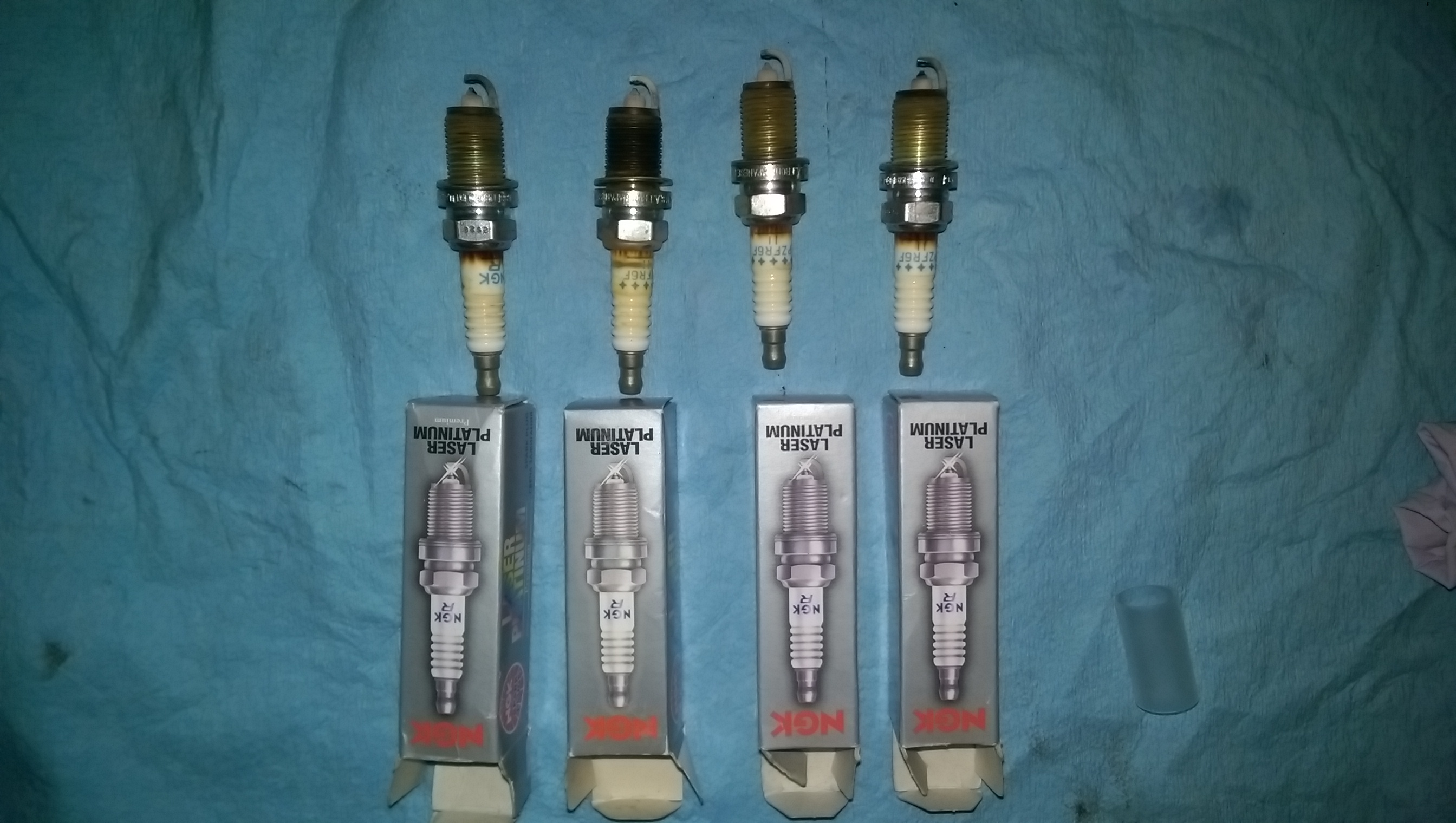

You beat me to the punch, Ezone. I was gonna say I bet my tool was not accurate. I have two of the gap tools and one puts the spark plugs really close to .043, whereas the other puts them all at .040. They are all installed and it took about 10 minutes total. I started the car, and it cranked like usual.
Below is a pic of the old spark plugs. They don't look bad, but two plugs have darker tips than the other, and all 4 are scorched at the bottom of the porcelain. Do these old plugs look like they aged fine or is there an indication of a possible problem?
Thanks.

Re: Spark plug gap question
The stains ("scorch") above the hex is corona stain, that's normal.
The one with blackened threads may have been a bit loose and allowed carbon to creep up the threads.
Thanks Ezone. Everything seems all good. I drove around for a few hours (put on about 45 miles) and the car feels great. Shifts good and accelerates good too. Not sure if this is an improvement over before, but with the old plugs in, the car drove fine too. No complaints.
