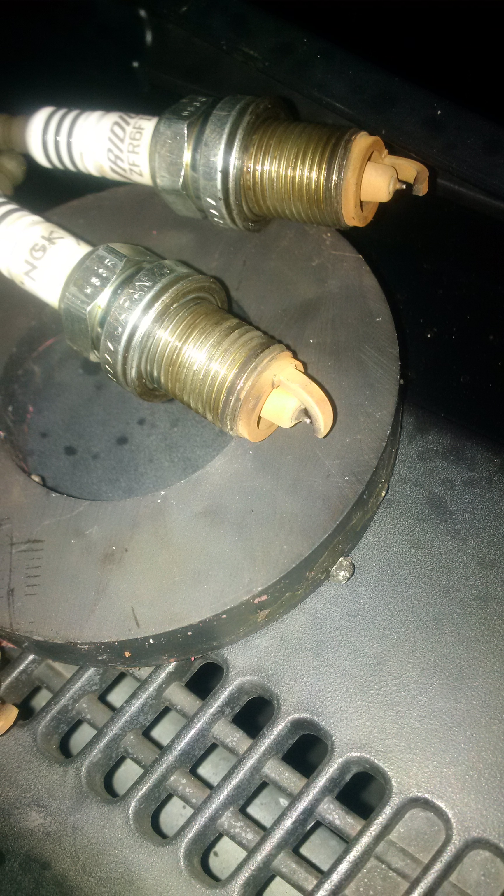

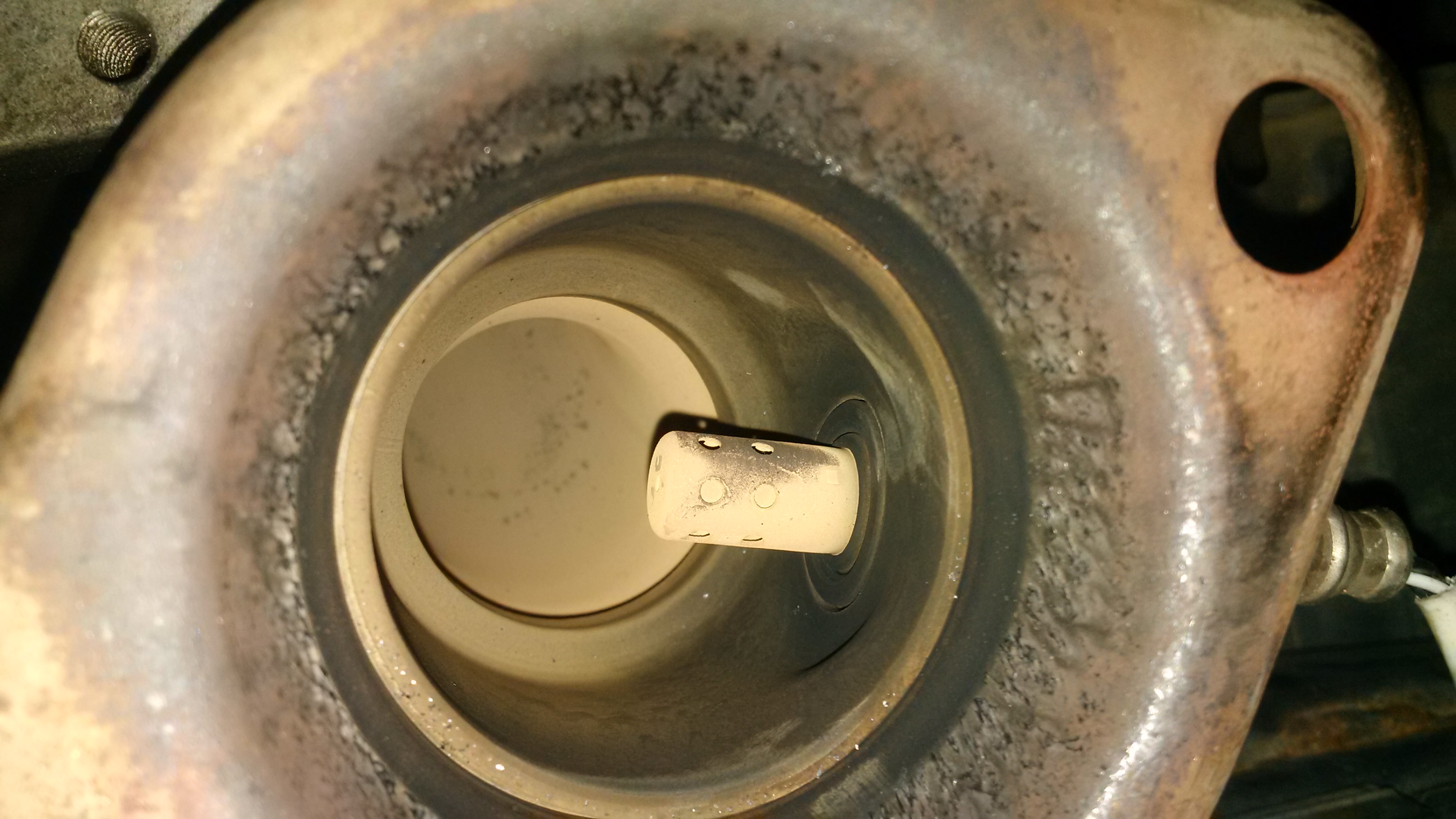

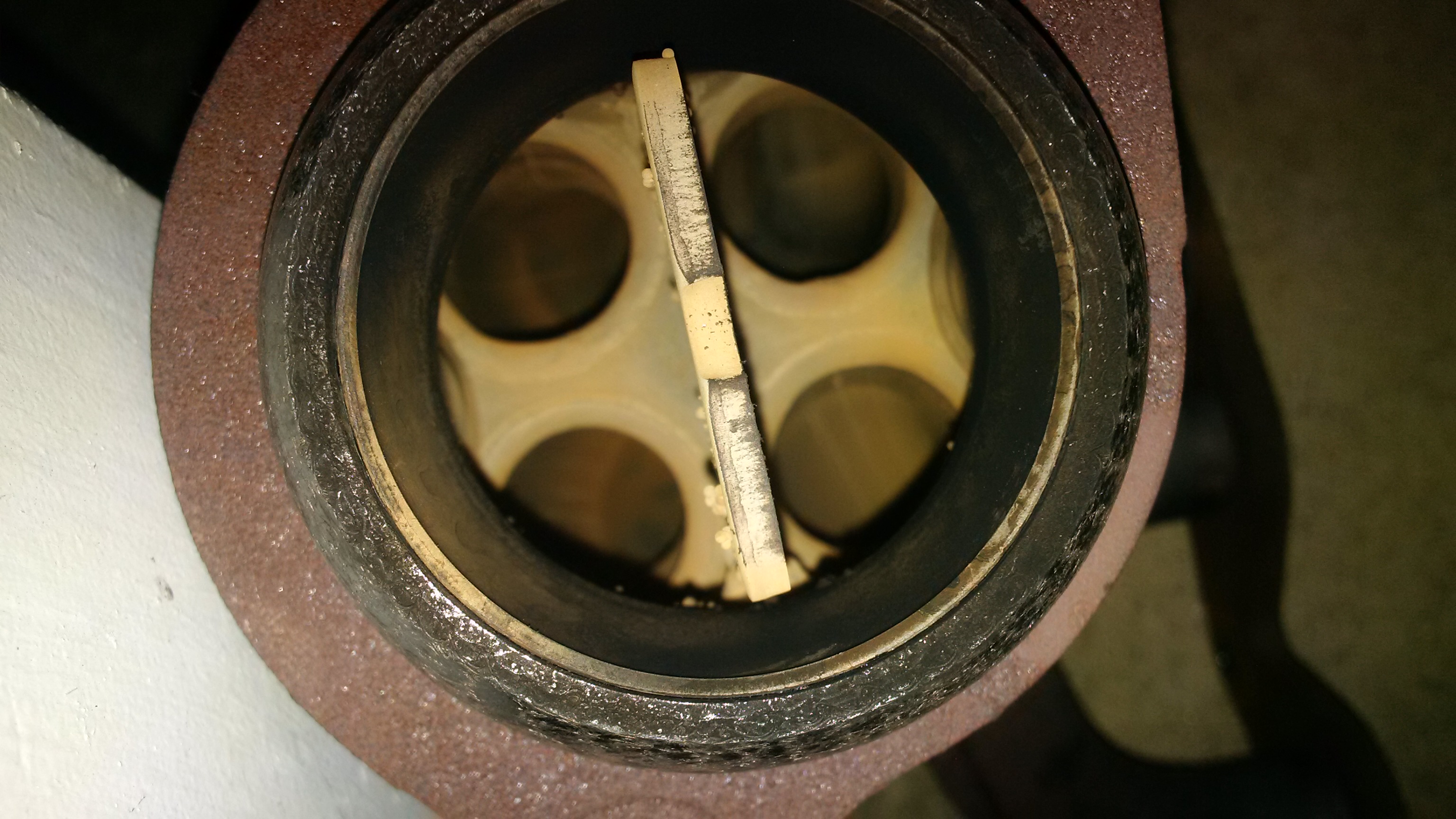

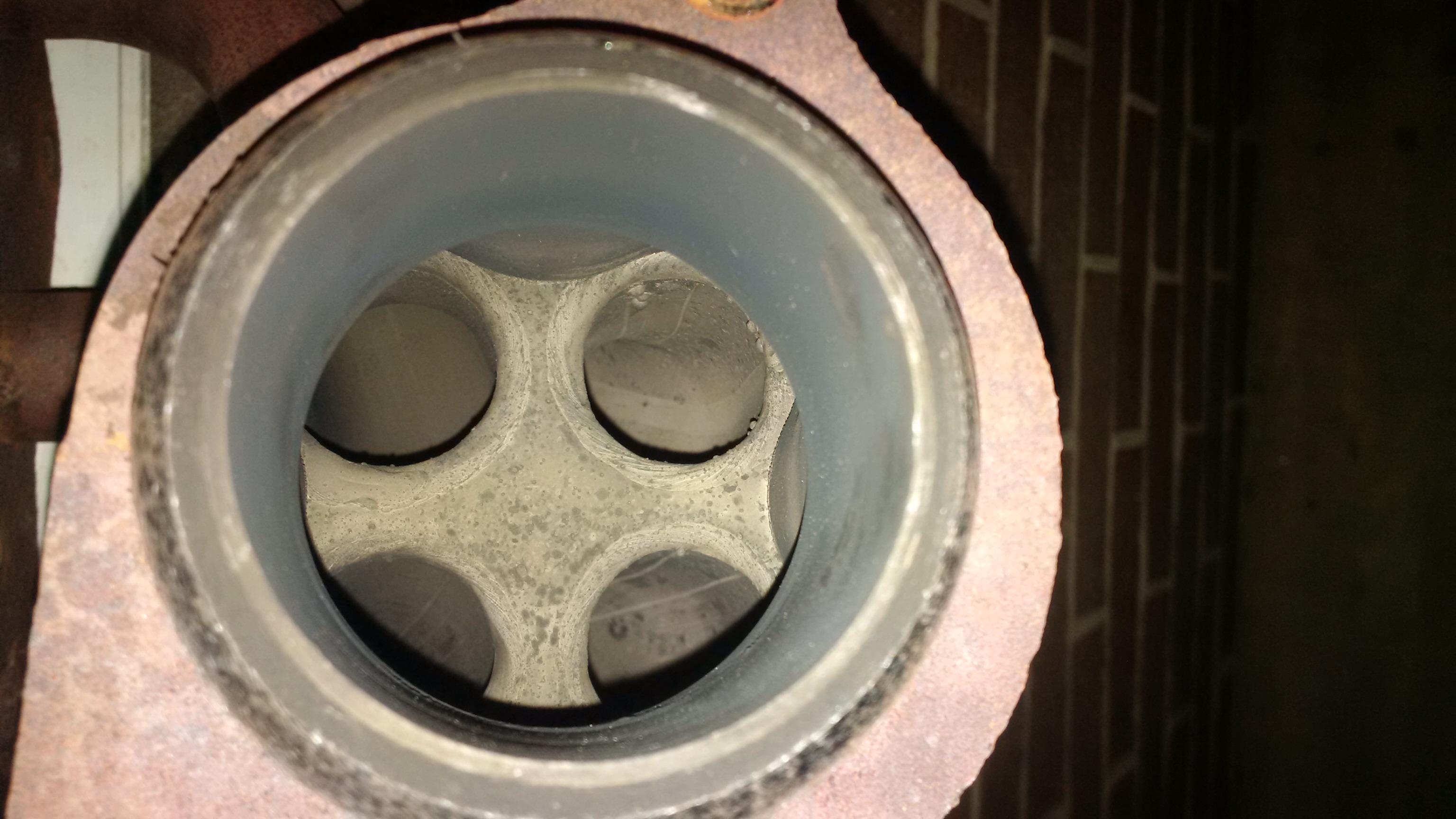

So I just got a new engine in my car and a couple days after driving it, I noticed the exhaust note changed and a couple days later I got the dreaded P0420. I'm stumped and I'm really not sure what could have caused it. On top of that, my plugs and exhaust pipes have this strange tan dust on them. I asked my mechanic about the dust and he told me it was because I was driving like a normal person. Maybe he is right and I'm just used to a rough running engine, but even in my wife's car that runs like brand new, there aren't deposits like that. Also, I had my cat replaced about 3 years ago, could it really have gone that quickly? I've included pictures of my exhaust. There are two manifolds, one, without the metal plate is the original one, and the second is the one that came with the engine that I ran for a little while after getting the car back.
That's what killed the cat.
You can ruin a brand new cat in a matter of only minutes if the engine runs bad enough.
Got pics of the inside of the cat? Is the element inside it all broken apart?

Unfortunately not. I haven't tried to tackle disconnecting the central silencer from the cat. By rough though I just mean either a blown HG or warped head. Never burned any coolant, or if I did it was minimal, and the oil needed to be topped off at 3k and then changed at 4k but other then that it was good. I was under the impression the head was warped though and with it burning oil at the rate it was, although not awful, I was taking preventative measures...that have now become a pain in my side. Never paying someone to do a engine swap again.

I figured when you said it was rough running that it had been running with misfiring going on.
Oil burning can slowly ruin a cat,
Coolant can slowly or quickly poison a cat
The contaminants can coat and clog the pores of the element so it cannot store and release oxygen properly.
Misfire and rich running can kill a cat in a hurry.
Lean and running out of fuel can kill a cat too, but it's not very common.

It seems like I hit a wall. Like after 4k it's sluggish. It just gets really loud and slowly climbs. I could almost red line my other one without much effort. I normally shift right around 4K, so I don't make a habit of running it past that, plus I'm concerned I'll blow a seal. I have a laundry list of things to test before conclusively say the cat is bad, but I'm stumped on the whole tan dust thing. My brother, a mechanic, said he though it was either somehow related to the cat, or I was burning coolant. I haven't found anything to back either of those thoughts though.
Old Nov 24, 2015
Rep Power: 518
Re: Intermittent P0420
Restriction. Intake or exhaust. Likely exhaust.
Disconnect the exhaust from the header or first pipe (disconnect ahead of the cat) and drive it.
If it will pull all the way to redline with cat disconnected then cat is clogged--- or broken apart and chunks are clogging the exhaust somewhere.
Bang on the exhaust pipes with a rubber mallet, listen for internal rattles (cat chunks)
What did you expect to see?
Honestly I'm not sure, I guess just clean, the plugs are brand new so I expected them to still look it. I've been inside a few engines and never seen anything like that, so I was a little concerned that something was wrong. As for the cat, I'll check my like and do a bang test, then drop the downpipe and see what happens.
Old Nov 25, 2015
Rep Power: 518
Spark plugs always show the last conditions they were exposed to.....If the last action was a cold start then shut off, the plugs would probably be dark and kinda sooty.
Manifold and pipes will be ashy under most normal running, with some soot depending on last run. Carbon is easily burned out close to the engine where the exhaust stays hottest, but pipes can stay blacker as you get further away from the engine.

Tan color is normal for a plug after a while, rust/orange color, nor so much.. Rust-color dust may be a result of someone, perhaps b/f you owned the engine, using an additive like an octane booster.
"Spark Plugs Turned Orange"

Well I just so happened to add some octane booster on the same tank of gas I checked the plugs. If you read down the thread I mentioned I replaced the engine because I thought the head had warped and it was burning a quart of oil every 3k miles which I didn't like so I replaced it as a preventative measure so I didn't run into worse problems down the road, now it's becoming a pain because I thought I was being smart.

I considered it more tan I guess. But I did run a thing of stp octane booster. Thought the noise was really bad knocking.
They look fine, but seem to have that orange tinge. They should be more grey than orange-ish if fairly new, and if the A/F mix is about normal.

Great, you just saved yourself a lot of trouble, and potentially cost of a new cat! ...which is why I mentioned A/F ratio above.
Here's the backstory to what I think may have been happening:
Fuel injectors on EFI engines are rated by flow/time. Usually cc (cubic centimeters) per minute. But when you look up ratings, they are usually listed as something-cc, omitting the /min. A 200 cc injector is really 200cc/minute.
My EX w the D17A2 engine has 240cc injectors stock (I think).
The ecu opens and closes the injector to control the amount of fuel that goes into the cylinder, and under normal circumstances that length of time is adjusted based on the feedback from an O2 sensor to get a good air/fuel ratio.
If you install a higher flow injector, and unless the ecu is reprogrammed with a new fuel map, then the midpoint of the control range will be off, and the ecu can only make adjustments within a small range.
So, if you ran with much bigger injectors, the A/F mix would have been crazy rich, and the ecu would throw out codes related to the O2 sensors and emissions. Using an octane booster or race gas actually makes it worse (chuckle).
So the plugs look dirtier than normal, they show deposits related to the octane booster, engine runs rough, and the cat converter has a really hard time of it cleaning up the emissions. If you were to crack it open, I bet you would find similar tan-rust crap inside.
From badasscars.com:
The problem running race gas (or octane boosters) is that if you don't have the compression to compress the fuel and air enough, you'll actually run SLOWER! I see this happen all of the time at the race track where during the Wednesday night drags, people with bone stock cars will go fuel-up with 110 or 114 octane race gas and wonder why they aren't running as quick, or as fast, as usual. Contrary to popular belief, the more octane in gas, the COOLER and SLOWER the burn is, and more importantly, the more compression is required to get that fuel to release its energy.
...OK, prolly more than you wanted to know, but it seems like you care about the car, so, something to think about...
