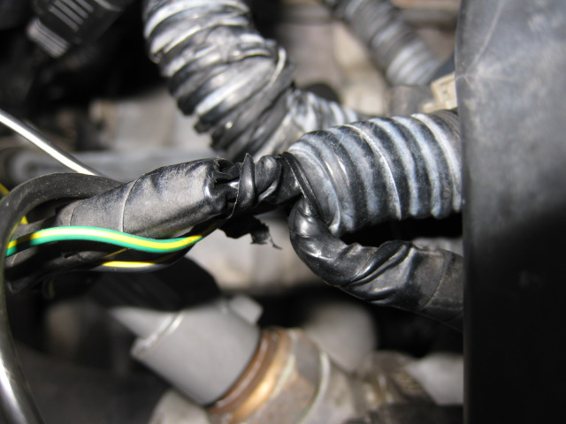

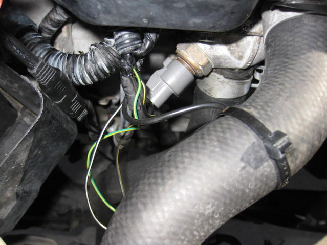

Someone took off the CA cat and headpipe and put on a header (no cat) and 49-state headpipe with the secondary sensor in the headpipe.
I see the wires and connector to the secondary but not the primary
here's photos of where the secondary wires arise from--
is this where the primaries arise also?
Can anyone take a photo of where their primary wires arise from and post it?
The white wire from the secondary sensor has been overwrapped with black shrink coating, so it is black exiting the harness-- a little confusing
Thank you

Old Nov 22, 2014
Re: CA car--where do the wires to the primary O2 sensor come from?
Well THAT looks hacked.
I'll try to get back on later and look up some wire harness colors....Gotta run now
Old Nov 22, 2014
Ok...
Got pics of that header mess and the sensors?
The connector shell I can see looks like it's for the secondary sensor.
On an LX car, both O2 sensor pigtails should come out of the main harness at the same area, because both sensors are (WERE) located right out front on the manifold/cat assembly.
The primary O2 sensor is an A/F sensor. (It's NOT a regular O2 sensor. It looks the same, smells the same, and does about the same job..... but is very different internally and the computer is different.)
Primary AF sensor: Engine harness wire colors are
White
red
green
red/yellow
The colors of the wires on the sensor do not correspond with any of the engine harness colors. They are supposed to be mismatched.
The secondary sensor is a regular O2 sensor. It's supposed to be located in the exhaust stream post-cat.
Black/yellow
black/white
white/red
green/yellow
Again, sensor wire colors do not correspond to the engine harness wire colors.
Your pics look like the secondary sensor wiring has been pulled out of the original harness and probably was extended to get the sensor relocated further downstream (post-cat)....Well, if it had been done the right way it would.
Your wiring harness for the primary sensor is probably still right there, just hidden. Try checking all those other harness branches, maybe it's tucked up under that big airbox or something.
And
There's some FAT spots in that bundle, like there are butt connectors (splices) taped over and hidden in the black tape. (pics 1 and 2)...Your primary sensor wiring might be in there, unwrap the tape and see what the original harness wire colors are.

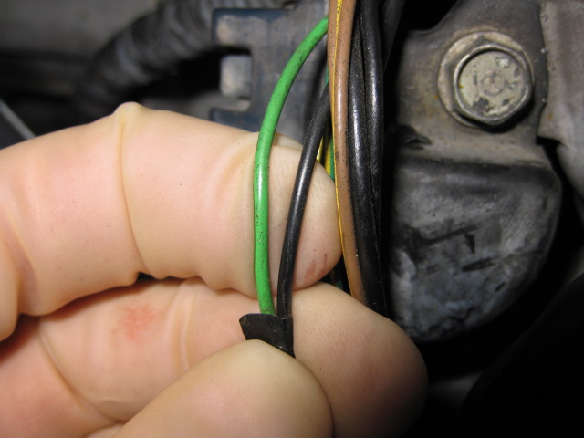

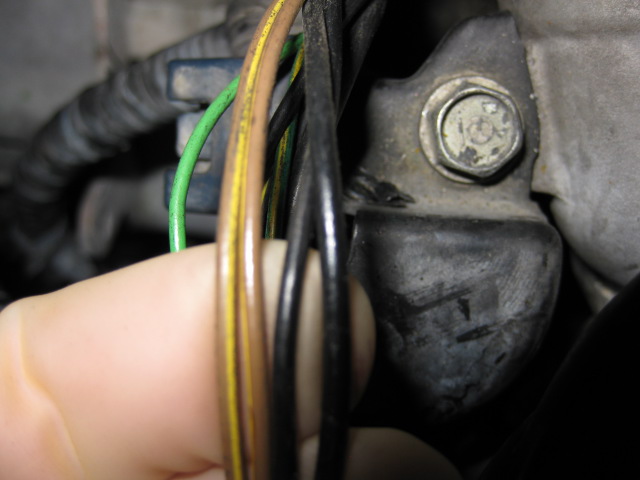

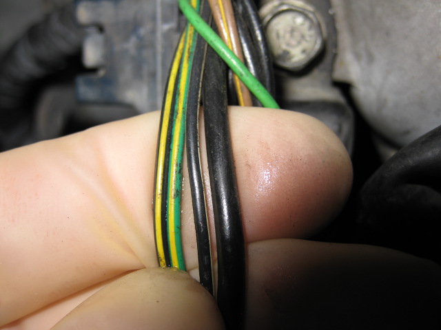

I removed the air box and cut off the plastic wiring loom stuff back to the previous Y-- still no wires to the primary.
Here are photos--
two black and 2 brown/yellow wires which go to the ground,
a green (or green/black?) and black going to the thermostat fan switch
a black/yellow, black/white, green/yellow, and the thicker black one which leads to the white wire on the secondary connector
What color wires are supposed to go to the thermostat fan switch?
Anyway, even if the green going to my fan switch is supposed to be going to the primary I'm still missing 4 wires.
I guess I'll have to cut back further into the wiring loom.
One thing that confuses me, though.
In your initial response to my question about the car being a 49-stater, you said it had a 49 state emissions system by code, which would correspond to what I am seeing. Is that right or is the code ambiguous and can be 50 or 49 state?
Thanks again
Jim

Old Nov 22, 2014

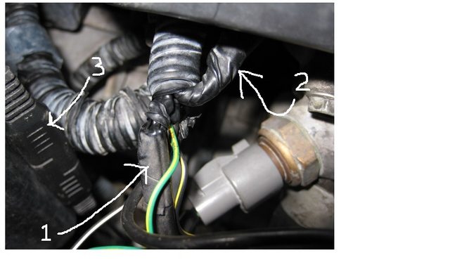

The plastic covers on the harness looked original.
It didn't look like that area had been messed with. Maybe it has, it's hard to tell from a pic.
Here's what I saw:
(Bow to my mad MS PAINT skillz!)
#1 is where I thought it looked like butt connectors have been taped over.
#2 I thought might have been the wiring for the primary sensor.
#3, I just wondered WTF that is because it isn't original to the car.
I'm guessing not relevant to the current problem.
The first 3 sound right....not the last.
Plain green wire and plain black wire.

#1 is I think some butt connectors, but it only goes to the thermo switch and only 2 wires enter it
#2 is just the 4 ground wires
#3 is the connector to the battery maintainer I have on the car because it was sitting for a week w/o use.

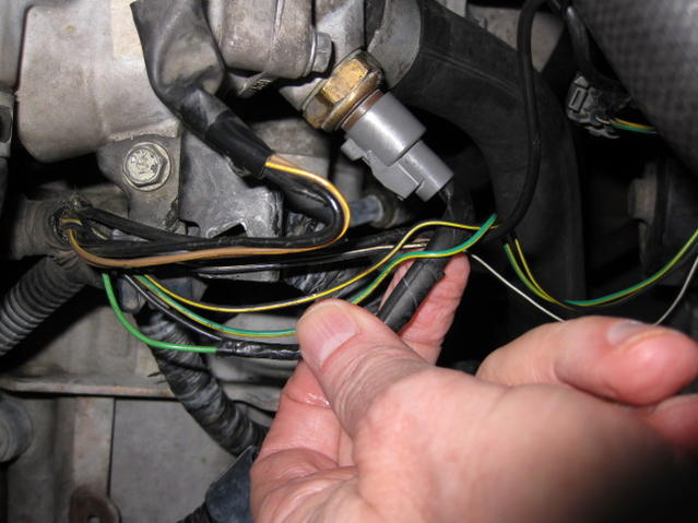

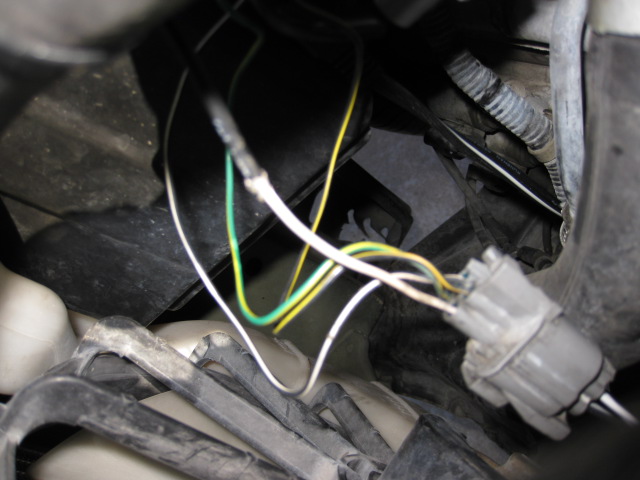

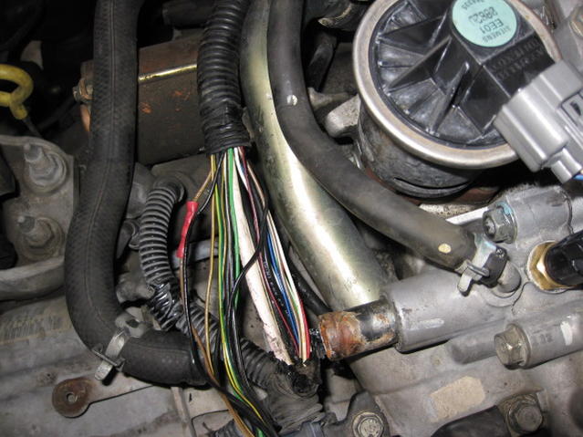

I have now removed the sheath from that part of the harness 4" back from where the wires to the secondary come out
the wires on the right are "newly found" and do contain some white, red, and green, but I need to see a wiring diagram to see what other wires are there with those colors.
(The red butt connector is where I repaired a wire I cut in dissecting the sheath off-- oops.)
Hard to find diagrams on google images.... It's also hard to find a diagram that shows everything at once. The factory diagrams are normally drawn in small sections and take several pages to cover a complete system.
Found what looks like the right diagram for the o2 sensors

update-- I give up. Took the car to a Honda independent specialist who will try to find the wires but will replace the wiring harness if he can't. He can't start on the car until next Monday.
Thanks for all your help
Jim
Old Dec 3, 2014
pantdino's Avatar
Joined: Nov 2014
Posts: 51
pantdino is an unknown quantity at this point
UPDATE-- Well, I took the car to the local Honda Independent shop and he told me he would have to replace the engine wiring harness and install a cat.
But then he discovered that someone had swapped in an EX engine and harness-- hence no second set of wires to the secondary sensor, since the EX has the cat UNDER the car.
I'm a little displeased because I would think as a Honda specialist he would know an EX engine at first sight rather than ordering a bunch of parts (some of which can't be returned), removing the exhaust manifold and harness and THEN discovering they were of no use because they were for the wrong engine.
Anyway, that's where we stand. His suggestion was to pull the EX engine and put in a used LX engine, harness, cat, etc for $4K. I said no because we have no idea how many miles are on the engine.
I think next step is go to the smog Gold Shield station to see if we can get a one-time 2 yr exemption while we sue the seller for the funds to pay for this.
Thanks for all your help.
