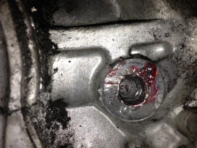

Hi, 2001 Honda civic Lx . There was a strange noise coming from timing area and car refused to start. When I opened everything and checked, Tensioner came loose and belt was flapping around. I tried to straighten thread with number M12 (OEM was M 10) but it just stripped first half of hole. Frustrated I used JB Weld on it and let it cure for 36 hours. 10 miles of driving and it again came loose. Tensioner wont take a M12 stud in it but i plan to drill it.
How to make a thread at this hole. Its a pretty tight space with car body close by. any ideas ? I will post pictures soon.

I would look at a Helicoil kit. You said you tried to fix the threads with a M12 tap, did you make sure to use a bottom tap?

@mikey there is a story to that but thats history. somebody in past overtightened that bolts years ago. after i bought this car and did a timing belt job and tensioner replacement 2 years ago, those internal threads were half stripped but still "catching" the bolt. So i left it that way but now continuous vibrations and force stripped it completely.

Now i plan to increase thread size to M12
weld an M12 and M10 stud together.
put on a tensioner and tighten it with M10 nut
what you guys think ?
Old May 1, 2013
pjb3's Avatar
Joined: Jul 2009
Posts: 425
Rep Power: 210
pjb3 is a glorious beacon of lightpjb3 is a glorious beacon of lightpjb3 is a glorious beacon of lightpjb3 is a glorious beacon of lightpjb3 is a glorious beacon of lightpjb3 is a glorious beacon of light
Re: stripped timing belt tensioner hole
Sounds like a lot of work. My concern would be that the stud you make is straight so that the tensioner runs true. You could have a machine shop make the stud for you but that would be expensive.
Like I said, I would use a helicoil.

Second the helicoil, but that machine shop work wouldn't be that bad either. BUT for something that could self destruct your engine I would trust the helicoil before any weldment... Not cutting down your machine shop, but helicoils are time tested.

One more vote for a helicoil. If done properly it will hold forever. Half my valve cover bolts are helicoiled and I have no issues what so ever. I've also helicoiled one of the water pump bolt holes that I managed to strip. That was 40,000 miles ago and still no problems.
Look into drilling a 3-4" access hole using a hole saw in the inner fender area to get a straight and true shot to the tensioner hole for the helicoil procedure.
You can always have the access hold welded back up later on, or just Jb weld it back up.

I used m10 x 1.50 helicoil (original was m10 x 1.25)
and wrapped silk thread around bolt which made it really tight. It went in tight and holding it good so far. I am hopeful that it would hold for 20-30 thousand more miles. Car is at 175000 now.
Thanks again.

Good move on the helicoil, could have used a timesert as well.
Much better then welding stuff together as you previously mentioned in my opinion.

I elevated engine, took off PS pump, alternator and left engine mount system. I also took off CKP sensor, crankshaft pulley.

Final solution to stripped timing tensioner bolt
Despair no more. I have the answer that you seek...:grin:
The car- 2004 Honda Civic LX 4 door
I had my timing belt/water pump done at a Honda dealership 22 months ago. I have nothing good to say about the mechanic that worked on my car. He overtightened the tensioner bolt, stripping it out.
About 3 weeks ago, the car went limp in the Publix parking lot, oil was spewing out all over the bottom of the engine.
I opened her up to find that the tensioner spring was all crushed up, loose near the crankshaft. The spring actually ate through the mounting hole on the tensioner itself-- Shocking how strong the OEM spring was. I'm guessing from the vibration caused by loose timing tensioner bolt that was stripped by the idiot Honda dealer mechanic. :hothead:
The timing belt was shredded & the engine was covered in oil (driver's side).
The crankshaft seal on the oil pump was cut (presumably by the loose spring). It came out in two circular pieces.
I put on a new cheap auto zone timing belt to check the compression. I feared that the valves were bent or worse. The compression came in 175-178psi. The engine was salvageable.
The big problem:
I was agonizing about how to go about repairing the stripped timing tensioner hole. I searched and searched for a easy solution. However, I found that there were 2 ways to go about it. 1) to lift or lower the engine to gain access to the hole by a drill, 2) drill a 3 to 4 inch through the left inner fender to gain access.
Lifting the engine meant I had to disconnect a lot of things. I was more worried about wires and hoses that may get ripped apart while attempting to do so. Lowering it seemed to be feasible, but the AC compressor had to be taken out. The lines had to be disconnected to gain access to mounting holes.
Drilling a hole through the inner fender was out of the question. It is a support area (rectangular box shape). I didn't want to compromise the structure.
I was looking at a Youtube video and a guy was drilling out the same hole on an engine that was out of the car--BY HAND. Because his small drill didn't accept the Time-sert drill bit. You may say, yeah, but the engine was out, and he had plenty of space. And he had plenty of leverage because he can put his weight behind the drill bit and tap wrench.
BUT, THIS CAN BE DONE WITH THE ENGINE STILL IN THE CAR!!!
You do not need to lower or lift the engine even an inch to gain access.
This is how I did it:
Tool you need:
1) Time-sert metric kit M10x1.25 part#1012 ($80 at Amazon)
2) small craftsman tap wrench (~$10?)
Remove everything to do a timing belt change, including the water pump (gets in the way of tap wrench)
Follow directions for Time-sert repair kit, but do everything by hand. Go slowly and carefully. It took me 5 min to drill out by hand. probably 20 min tops to complete the repair.
We don't need space for a drill. Repeat, we don't need the space for a drill! You have at least 2" of space left with the drill bit and tap wrench.
I think the idea that we need to gain access with a drill is making this more complicated. Get that out of your head. The block is aluminum and the hole is already there (you're not drilling a fresh hole) you're just making the hole slightly larger.
I was very surprised at how easily the drill bit cut a new hole into the block.
I reassembled everything using all new OEM HONDA parts. Runs like butter now.
I hope this post will help many in despair and agonizing about how to repair the stripped timing belt tensioner hole.

Re: Final solution to stripped timing tensioner bolt
this has never happened to me, but im just curious
if you make the hole larger, wouldnt you require a larger bolt?
and how would you fit a larger bolt through the tensioner?
Old Nov 26, 2013
HeliCoil/Time-Sert thread insert. Same bolt as original.
Old Nov 26, 2013
Mr.H's Avatar
Joined: Nov 2013
Posts: 2
Mr.H is an unknown quantity at this point
The insert from Time-sert kit fits in the larger hole. The outer threads of the insert matches the new larger hole. The inner thread of the insert matches the factory bolt pattern. You are using the same factory bolt.
I forgot to mention the bolt took full 33LB fT of torque.
Just noticed that a lot of activity happened under my thread while I was not following. I did this by hand and it was very easy. Stuff is still holding tight even after a year and 12K miles.
thanks for all the help
