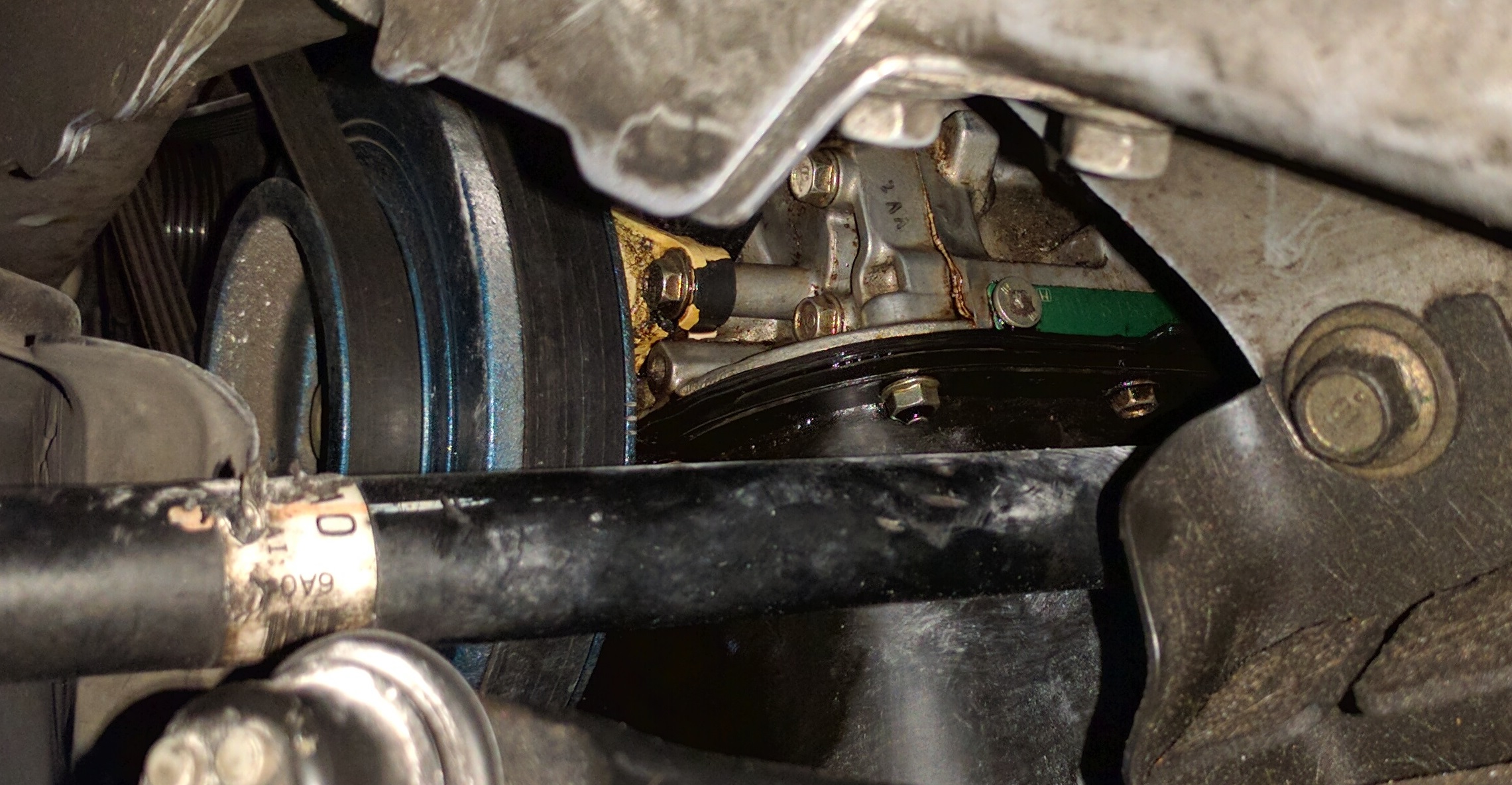

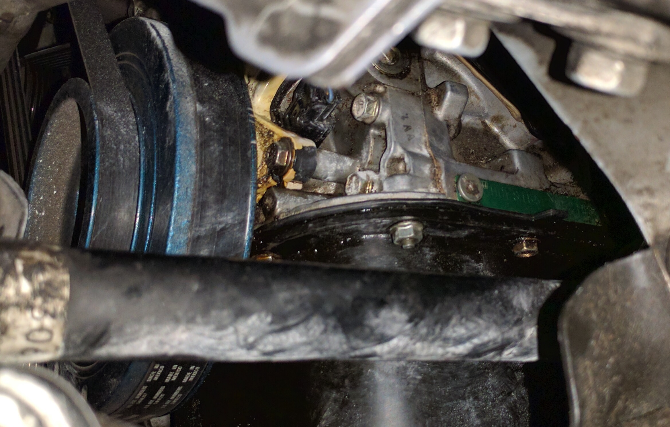

I have a 2003 honda civic lx with a slow oil leak that I believe is originating around the top of the oil pan. It seems like there is a lot of experience in this thread with oil leaks in this area so I'd love to get some input.
The two attached images are taken a day apart. One image is after cleaning the area (and applying some powder) and the other is after one day of driving (commuting ~50 miles).
It seems the oil is pooling along the oil pan gasket but I also see some oil above it from the cleaned pic to the dirty pic.
Any ideas where the leak may be coming from?

Re: Oil Pump Seal Leak?
Definitely looks like the internal oil pump o-ring as pointed out earlier in this thread. JMO based on your photos and info.
Old Sep 30, 2016
  #84
^Agree. Next step might be to take the timing covers off and make sure nothing above that area is leaking oil.
Next question is, how big is the leak and is all that work worth it?
Or can you keep up with the rate of leakage and add oil when necessary?
could be crank seal also,
just make sure that oil is not getting onto your timing belt, oil will destroy a timing belt very quickly,
on a side note, why is your crank pulley blue?
or is that just the picture making it look that way?
Took off the timing belt cover and doesn't look like there's any oil getting on it. No idea why my crank pulley is blue (it really is), I did get this car at 120k miles so who knows what work has been actually been done on it.
