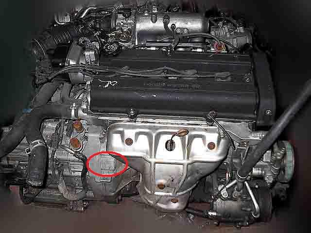

Look at the engine block stamp. Facing the engine, it should be to the left of the exhaust manifold, right next to where the engine connects to the transmission
Here it's shown on a B series, but it'll be in the same location on a D series.
If it says "D17A2" then it came out of an 01-05 civic EX.
edit: If you really feel like figuring out exactly what car it came from, there may be a VIN plate on the backside of the engine block. When I swapped my engine, there was a green plate with the original car's VIN on it. A quick google search showed me similar plates on the backside of other engines, as well, so unless someone can say otherwise, I'm gonna say it should be green. Will likely be difficult to see that plate with the engine installed, but it's another identification marking. You can take that VIN an plug it into VIN decoders (or go to www.hondaautomotiveparts.com and enter the VIN there so you can find OEM replacement parts for that specific vehicle) and figure out what it came from.
