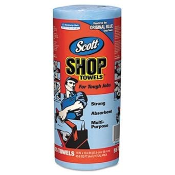

Bit of a late reply, but I'm wondering when you say "disposable towel" do you mean like a shop paper towel or an actual thick towel?

Disposable, diy throw away when you are done...., as opposed to the washable red or white cloth kind used in regular shops and serviced by the uniform company.
These bad boys is what I use.
