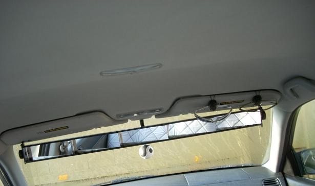

The vibrations were mostly eliminated with the velcro on my visors (not bad at all). Initially I tried fitting the window mounts but couldn't find a good angle (the mirror was always pointing down). So I used 10-24 x 1 inch bolts with a matching washer and nut after drilling through the visors (because I didn't want to drill through my roof). The only thing I'd do differently is to first burn through the marked visor fabric with a hot nail or something so the drill wouldn't catch and rip a big hole in the material (it was mostly covered by the mounts at least).

You know, I didn't like the idea of poking sheet metal screws through the convex roof liner in hopes of biting into something without going all the way through the roof, and the visors would not have opened all the way as far as I could tell. There was no need to remove the other mirror given the placement of the new one (besides, that's where my orb goes).

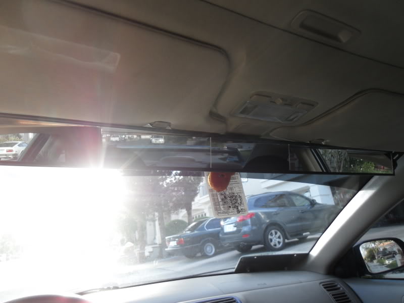

I just picked one up at a Pep Boys. Just thought I'd share my install.
Still got use of my visors, though I have to pull them out of the inner bracket to lower them

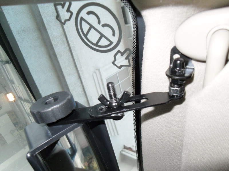

Driver's Side Bracket

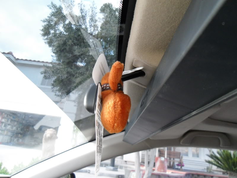

My Burger King Chewbacca from Jan 2005 still has a place to chill

A little aluminum spacer I made. It pushes the rest of the brackets in 9/16". Luckily for me, I didn't have to bend any metal for this one. The 3-sided aluminum rod (I guess you'd call it.. lol) was perfectly spaced.
Original bracket ground down a bit (I had some rubbing issues with the visors earlier) on top, 1/4-20 allen head bolt with wingnut, to a piece of aluminum cut 2.5" to make the bracket extension.. Painted it with black epoxy based appliance paint.

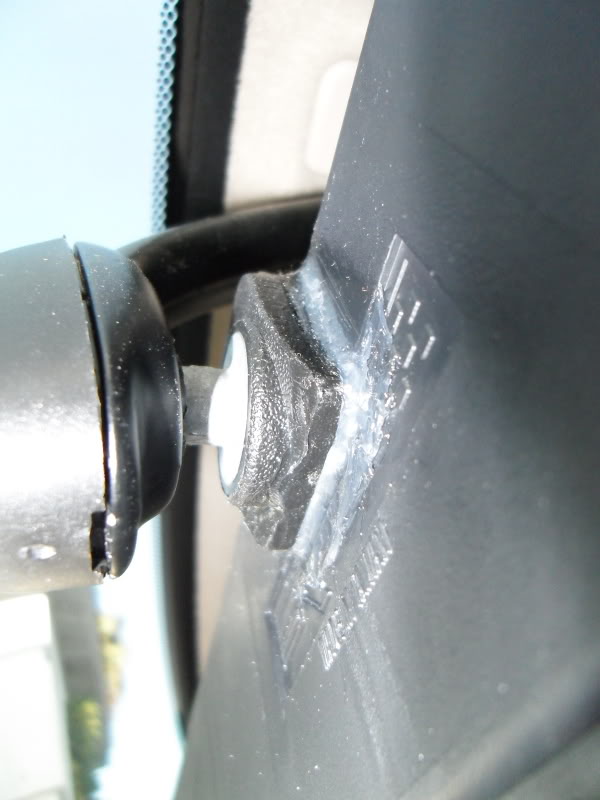

Ball joint from OEM mirror glued to back of the wink. Its actually glued on by Sumo Glue in the center for strong adhesion, Superglue on the edges for quick drying to hold it in place as the sumo glue cured, and the edges sealed with silicone for good measure.. I had some clear silicone lying around, otherwise I woulda went out and bought some black silicone.

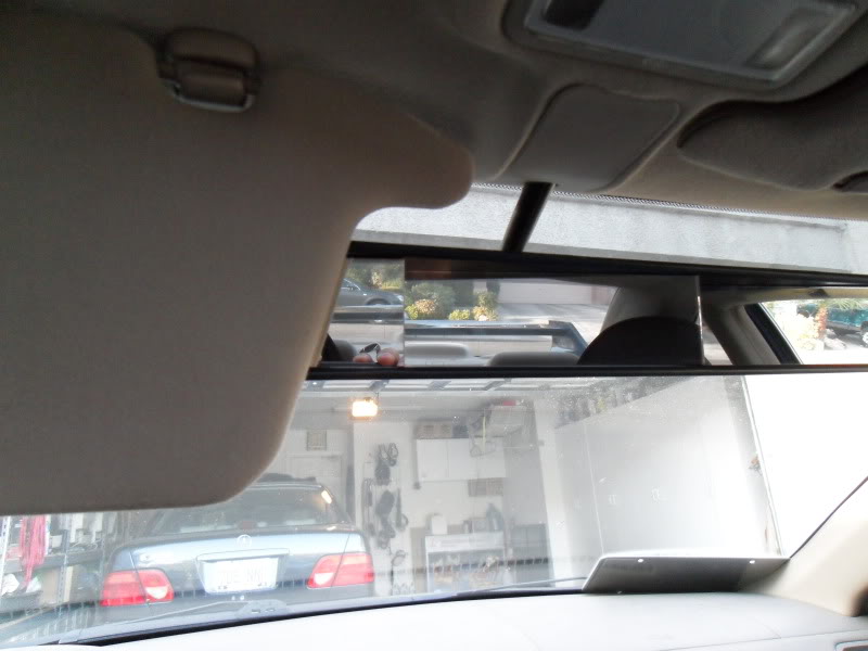

With the wink dropped down and back, I can see 3/4" of my rear window with the driver side visor dropped down. Visor use is an absolute necessity in Vegas. The passenger side visor just blocks my view of my passenger side blind spot.
