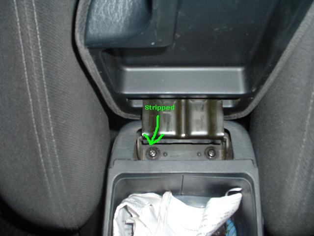

Thanks but I still need to find out how to remove the damn thing. I know there is a DIY but thats for an automatic. So then I tried to remove the entire console but I stripped a screw severely and now I'm "screwed". I stripped the arm rest hinge's screw. Is there still hope? Can I still remove the deck?

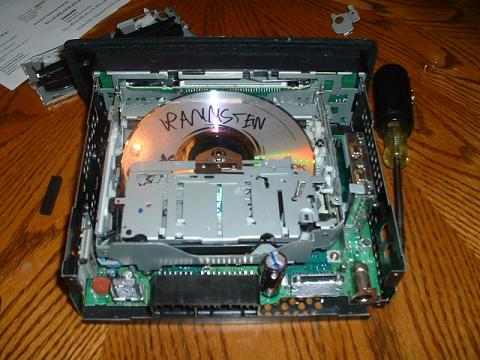

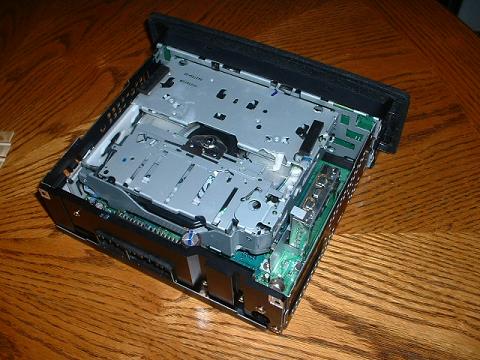

Ok, I finally got to my deck but now I need to remove the CD mechanism out but I don't know how, I'm stupid. There's some screws in there that aren't magnetic and I'm afraid I'll lose them. Please tell me how. Here's what I got done so far.

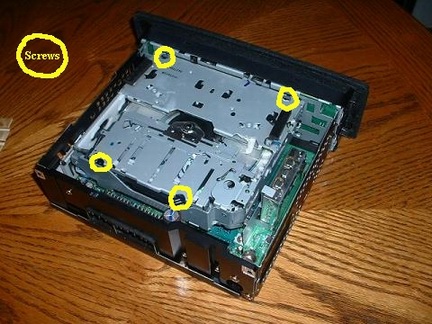

OK, you have the newer deck. All you need to do is take out the 2 screws in the front of the mechanism and 2 in the rear. You'll see them on the bottom of the mechanism when you look from the top. 4 screws in all. Then the entire cd block just pops up. There is one connector on the right when viewed from the front. It's hidden underneath and holds on to the cd block. Just lift straight up.
