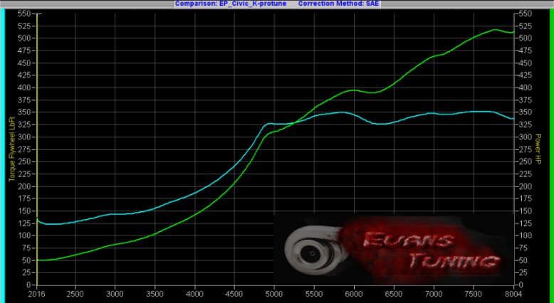

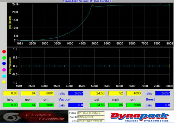

I finally got my car dynoed saturday on race fuel. I didn't expect to make this much horsepower. I was only thinking of making around 450whp. On 1000cc injectors the car still idles stock and I got around 28-30 mpg driving back from PA. Its going to be awhile till I run my car at the track with race fuel. I'm still deciding on what clutch to get. My exedy stage II is only rated for 275lbs of torque.Full boost comes in @4800 rpms.
Heres my setup:
precision sc61
wiseco 9:1 pistons
eagle rods
cybernation manifold
3" downpipe, 3" exhaust
1000cc injector w/ resistor box
3 bar map sensor
converted fuel retun line,walboro255lph, aeromotive fpr
kpro
hks bov
tial wastegate w/ 15lb spring

i see the pix. that is very nice. i dont think i got 28/30 mpg stock...jeez.

pics work for me.. AWESOME #'s!!!

When I'm driving around normally (under 70kpa map pressure), the kpro ecu makes sure it maintains an a/f ratio of 14:1. Once I go full throttle it'll start guzzling fuel.

wow you have jackshit hp at 2000 rpms ... then it jumps 10x haha

Holy cow! The power keeps on climbing and climbing and climbing... Thats amazing.
