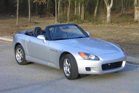

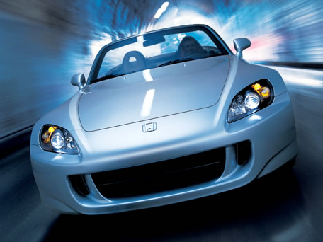

hey i was wonderin if any one is familiar withthe 2004 S2000, and the older ones.
i was wonderin if the head lights from the 2004 could fit onto the 2000-2003 models. and what about the tail lights?

i work for honda/acura. they are the same shape but the bulbs are different. It wouldn't take more than an hour or so to rewire the right bulbs for the turn signal/parking lights. the rears are different as well - for the taillights you would just buy a 2004 wiring harness - its like $30 from a dealer parts department.
