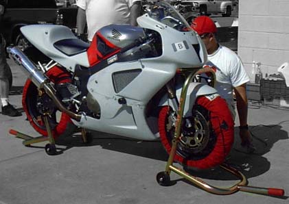

The reason I'm afraid to lower the car is 2 things: Scraping the fairing/front fender on driveways, harsher ride, and incorrect camber that will ultimately give me worse traction (?? just wondering ??) than stock.
Do replacement suspension components allow for the correct camber adjustments/toe adjustments? I have no clue.
Old May 19, 2004
xHoteKx's Avatar
Tomotor
Posts: 4,407
From: Canton, Michigan
Rep Power: 341
xHoteKx has a spectacular aura aboutxHoteKx has a spectacular aura about
nice bike

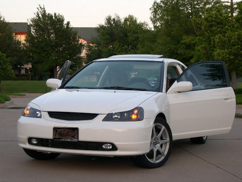

acidbaby's Avatar
The Beez Kneez
Posts: 3,759
From: Und3Rgr0unD
Rep Power: 315
^^^^^^^thats exactly what i got and it looks and rides great without a drop.. the pic below is what that trie size looks like i think the fit is awesome. i dont need to drop the car just to make the tires fit usually with lowpros and bigger wheels you get this huge gap
