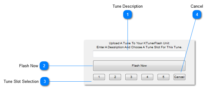

  6. It'll ask you if you want to erase the ECU and upload the base code. Yes you do. From there, another dialogue box will open up
    image source: www.ktuner.com
    If you just want to upload one tune, skip everything else and click on the "Flash Now" box. If you download the TunerView app and wish to flash to different tunes down the line without hooking up your computer, Fill out a brief description in box 1, choose a slot (1-5), then click flash now. Repeat steps 4-6 with different slots for different tunes.
