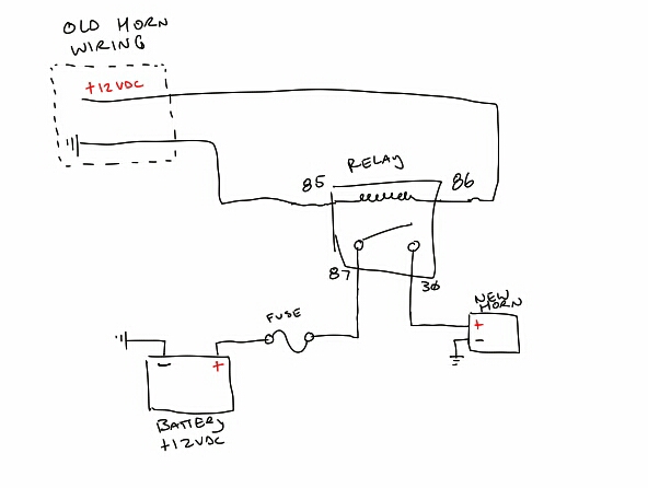

I am going to install a new horn, yet to be determined, on my 2017 Civic. However, it will draw more amps than the wire going to the small wimpy horn now. So I need to use that wiring connection to fire a relay that fires the new horn which I will wire to the battery with large gauge wire.
Can someone help me on how to do that please? Or show be some DIYs that show how to do it.
tex

I got you covered. Very basic wiring diagram. Easy DIY if you have soldering skills and a supply of wire

Thank you. Are there horns that come with the proper relay with the horn?
What would be an example of a relay to get for a Big Boy, or some similar horn?
tex
Old May 2, 2017
Rep Power: 512
Re: Help with horn and relay
any automotive 4 pin (or 5 pin, for that matter) relay will do. Just make sure that it's rated to exceed the load to which it's supplying. If I'm not mistaken, most automotive 4/5-pin relays are rated for 30A/40A at 12VDC, which should greatly exceed that of an aftermarket horn. If you can find a a relay and a wiring harness for said relay, it'd be better, considering the relay will likely be mounted where it'll be exposed to elements of sorts (vs. mounted inside the cabin of a car).
As for inclusion of a relay with horns, I'm not sure.
What's the amp load of the horns you're looking to use? I've been eyeing the Hella Sharptone horn (set) and many DIY guides out there say to use a 15a fuse in line, which is what the OEM fuse size for my car (2002) uses for the horn
