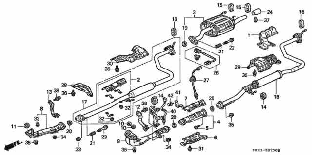

here's a layout of the 6thgen exhaust system:
Part number 8 and 17 (in the box) is the exhaust setup in the DX
Part number 9, 4, and 18 is the exhaust setup in the EX.
Biggest difference here, the DX exhaust has an exhaust manifold that has a 4-1 design (4 runners [pipes] that collect into a single outlet) with an integrated catalytic converter.
That said, the downpipe (part that connects just downstream of the manifold), is a single pipe that then connects to a long mid-pipe, then to the axle-back portion that has the muffler.
The EX exhaust manifold has a 4-2 design (4 runners [pipes] into 2 runners [pipes])
That said, the downpipe has a 2-1 design, that feeds into the cat, then into the midpipe, then into the axle-back portion with the muffler.
The axle-back portion may or may not be the same, but part number fitment says it only fits the EX (might be different muffler design, angle of the flange, etc.)
In order to use an exhaust made for an EX, you would have to swap out the manifold, downpipe, and cat, extend O2 sensor wires to reach the cat's new position, then bolt on the EX exhaust portion
