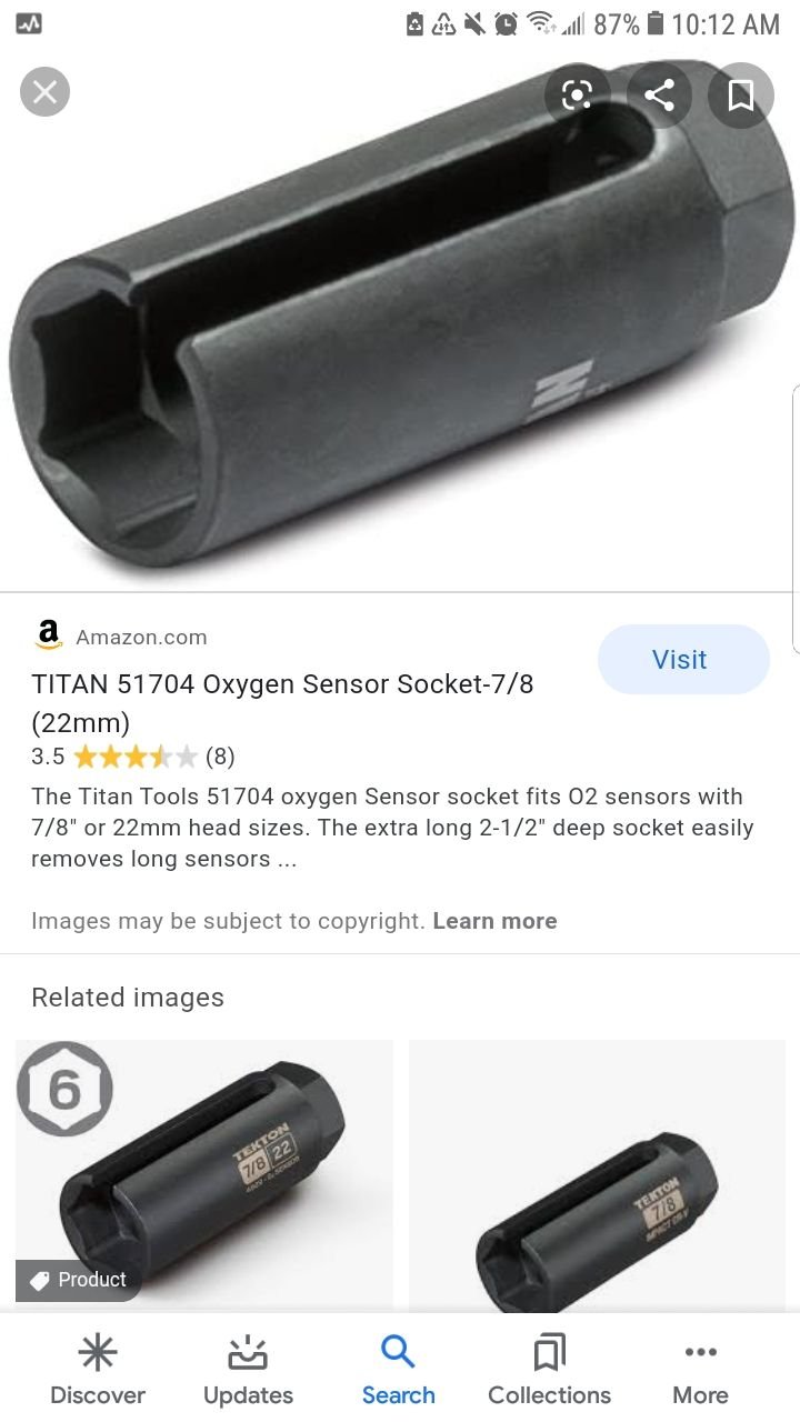

Running the factory O2s is way easier and probably cheaper.
-spray O2s in penetrating oil
-use an O2 tool to remove them
...if the sensors are damaged, but new ones (make sure they are from Honda, or direct from denso).
