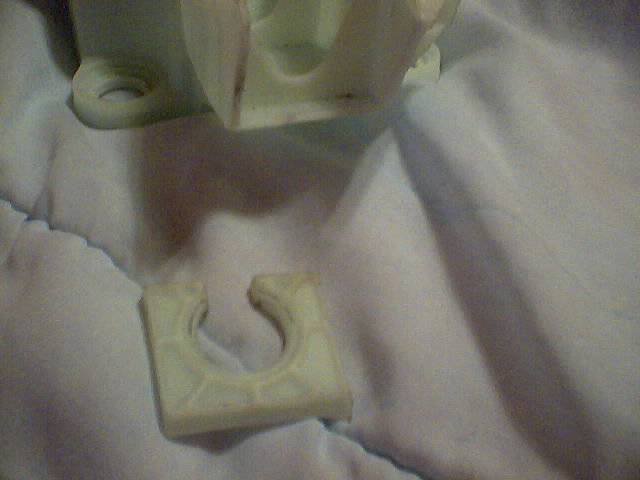

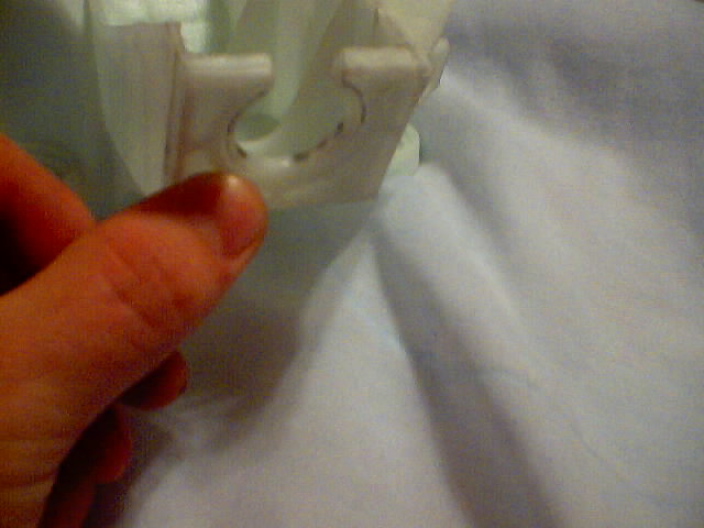

I was out at the track last night. During my 4th run down the 1/4 my Revo Short Shifter broke. The car was still able to be shifted through all the gears. Anybody else had this happen before? I just installed the stock one again =( looks like i
ll be in the market for a new short shifter kit...
check out the pics...

if that part breaks, that means your 3rd gear engagement isnt flush enough.
what i mean is, if you have trouble going into 3rd gear sometimes and you have to force it in.. then you might not have aligned the shift cable up correctly to the bracket.
or you're not shifting properly enough.. dont just simply slide the shift stick out of 2nd and slam it into 3rd, bringing it out completely then move up may help.
you'll know what i'm talking about if you take a look at how the shifter cable works when you shift into 3rd. the cable should go into the plastic cable surrounding without problems. greasing the cable and the surrounding may help too.
the stock clip that you took off in that area might have contributed to it too.. if it doesnt hold down the shifter cable well enough. I think in Grey's kit there's e-clips that you can use to fit it on better. or you can go to your local home depot/tool store etc. and look for the eclips.
if you decide to glue it back.. use some heavy duty ones.. best bet is to use some extra protection like taping it with heavy duty tape.. or surround it with fiberglass molding etc.
there is a problem with the revo in that the plastic housing they use isnt as strong as the stock one. I have mine for years now without issue, but then again I had all my joints and parts properly greased and checked on them periodically.
B&M isnt complete assembly but its pretty much complete swap. in that you swap out the stock shift stick and add on adapters and all these stuff, search it up. you'll see more info on it. although there's certain issues with B&M ones bending people's cable too. might want to check into that.

good info yoda.. i'll see what i can do.. i'll def reinforce it before putting it back on.
