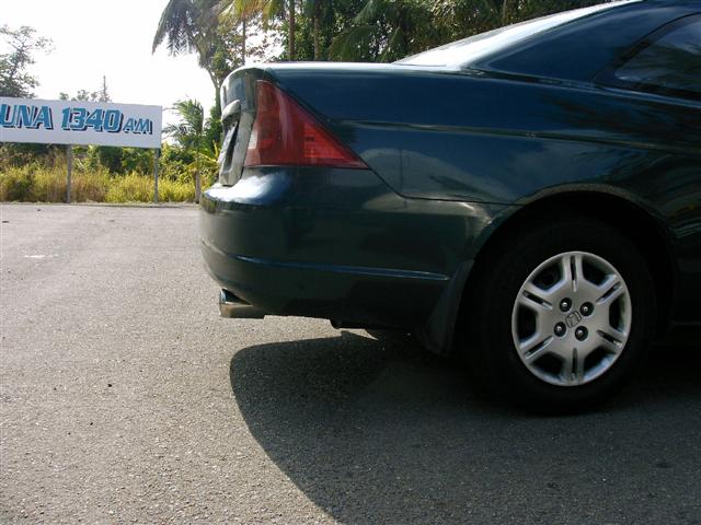

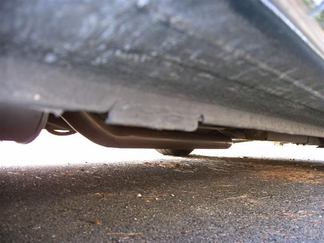

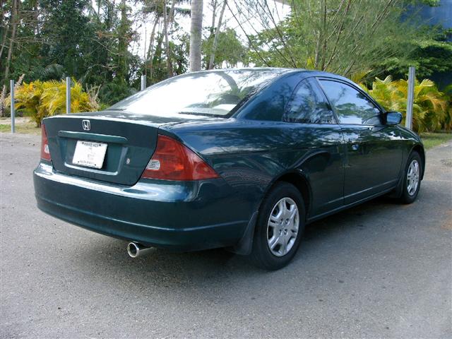

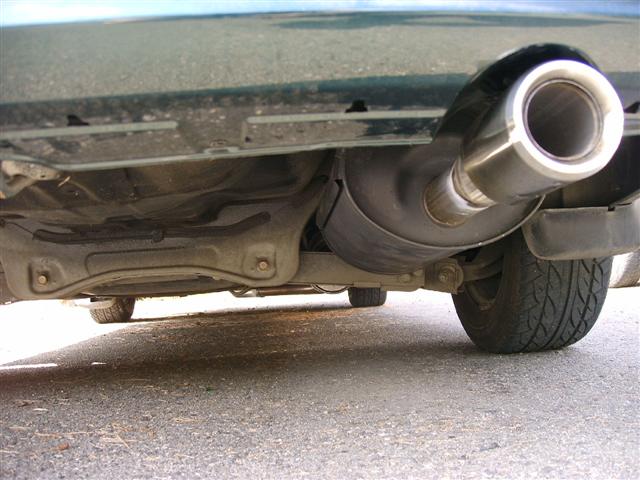

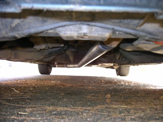

The Exhaust won't connect directly to the cat, some fabrication has to be done, also the rsx is shorter, so you have to extend the tail pipe a bit to match the bumper. The Type S exhaust comes with a nice tip you can fit in the 2.5" tail pipe. Mine's a DX so I extended the 2" pipe all the way to the front. If you look at the pipe pic from front, you see that the rsx midpipe ends after the first bend, while the civic ex ends after the second bend. The rest of the system fits the same position without any problem. The Resonator is bigger as well as the muffler the system isn't loud. I paid $40 for the install and modification, including the pipe extension.

The exhaust is basically the same shape as the civic exhaust, but the muffler and resonator are bigger as well as the piping....giving higher flow....basically the same thing as getting an aftermarket exhaust....bigger piping, but by getting a used one, not brand new, you can save a lot...you can get a used full RSX Type S catback system for less than $100 unlike a new one or an aftermarket exhaust. All you have to do is modify two things to make it fit perfectly.
