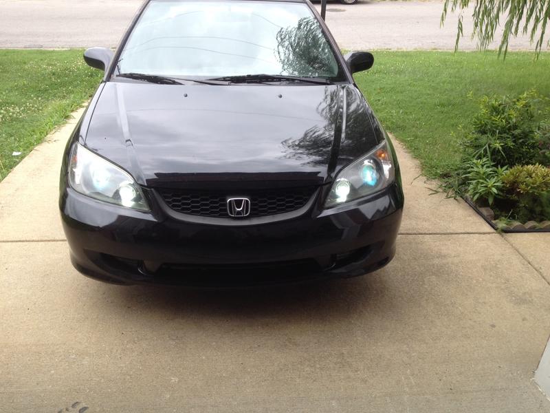

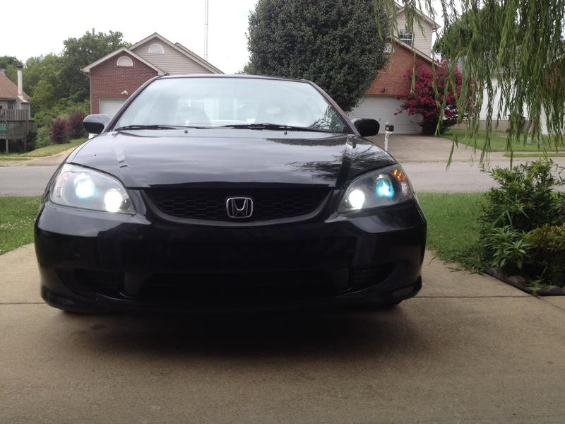

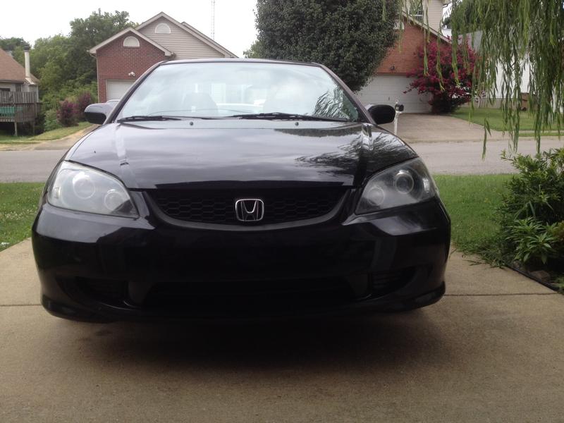

Red face Quad retrofit
FX-R lows
Mini H1 highs
Morimoto xB LED Angel Eyes (not wired yet)

Re: Quad retrofit
That's a lot of light!!

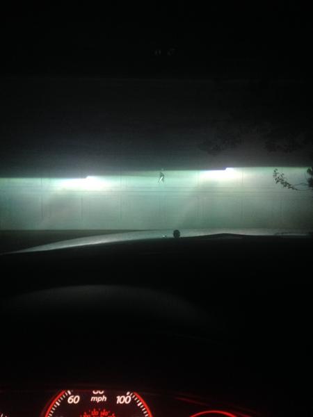

Re: Quad retrofit
I'd love to see the cutoff pattern at some point!
I only aligned the low beams as best as I could. I was also on a slight slope in a driveway so I had to adjust for that as well. I learned a lot from doing a quad retrofit, and if I ever do a next one, I will do it even better.
Originally, the FX-Rs called for a JB Steelstik/ JB Weld mounting method. However, it would not hold steady at all. Instead, I drilled holes in the reflector and housing and used nuts to hold the low beams in place at a good cutoff with them already in the housing torqued down.

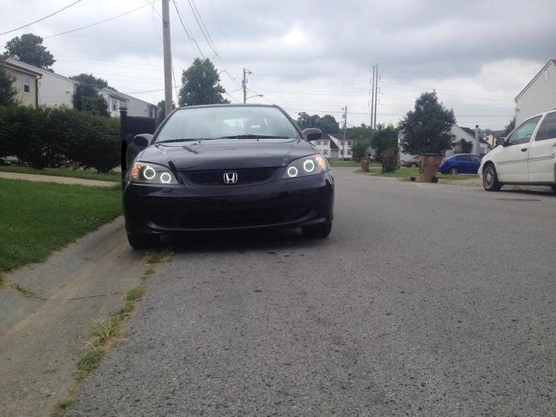

Angel eyes
Hey guys. This is an update on my headlights from last month. I had wired the angel eyes but forgot to upload a picture. Well, here are the angel eyes that turn on with parking lights. I figured it would be a good option to wire them like that as there is no DRL relay in our civics unless you are in Canada.

Re: Quad retrofit
Looks great! I use mine all the time!

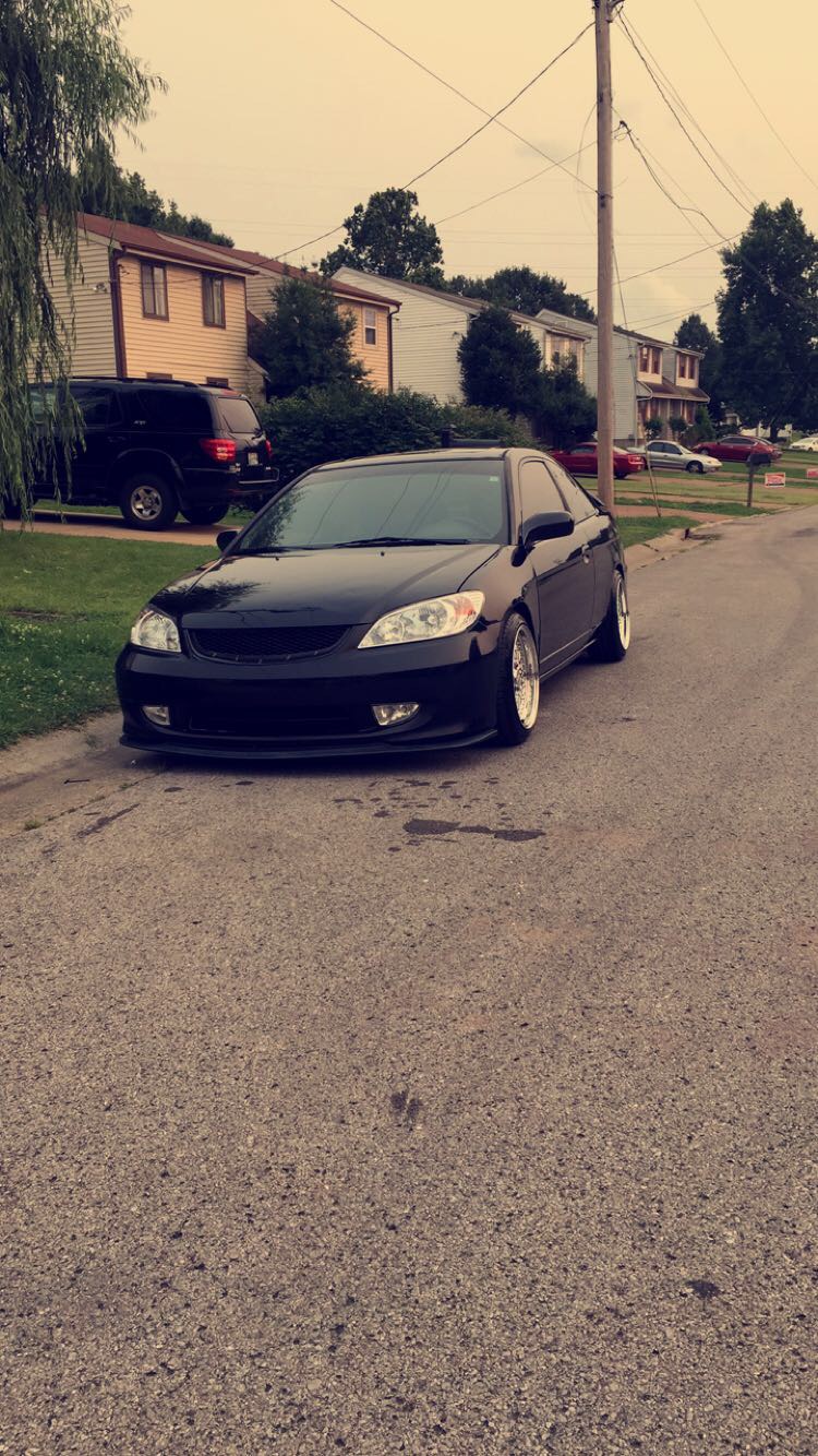

Just an update on the project.
The guy at Electronic Express is retrofitting the Mini H1s into some TYC brand headlight housings I bought from RockAuto.com. I will probably have them in a month. Currently I am riding around in stock headlights and stock halogen bulbs. I can live with it for now.
I ditched the angel eyes, as I wanted to keep it real simple.
I sold the FX-Rs projectors on Ebay.
While I do agree angel eyes can look nice, I think for the 03-05 models that keeping them simple is the way to go. I'm shooting for the OEM look as if our Civics came with low beam projectors from the factory. The only thing non-OEM would be the housing and trim being painted black.
Btw, I ordered my new HIDs from DDMTuning. I think they were 5000k 35watt with slim ballasts.
Ill post some pics of the retrofit in a month hopefully. I've attached of a pic of what the car currently looks like.
