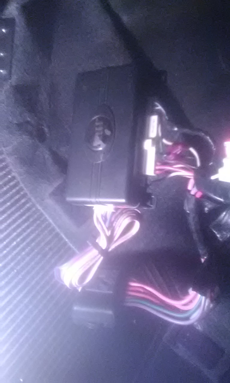

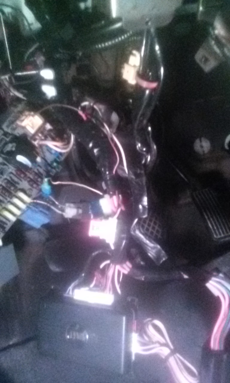

i am new to this page and to building vehicles this 92 civic hatch is my first build and i am putting an h22a euro type r into it. i have been trying to start it recently (to no avail sadly) with my s300 chipped p28 but running out of options when troubleshooting, recently i tried using a p13 from an obd1 h22 prelude to start my car (still no success) but this started clicking a bunch and trying to start my car so i turned the key off and pulled it out of the ignition, but this thing kept clicking and trying to crank the engine over. Can anyone please tell me what the hell is it and maybe why its doing that?
p.s sorry for the poor resolution my cheep phone is all i have to take pictures with.

Looks like an aftermarket remote start system.
Unplug all connections from that black box and see if the car goes back to normal.
You could remove the box and non-factory wiring, and restore modified factory wiring to original condition.

hey i got all of that removed and the factory original wiring restored but the car still wont start. thanks for the help! i will be installing a new ignition coil tonight hopping that starts it.
