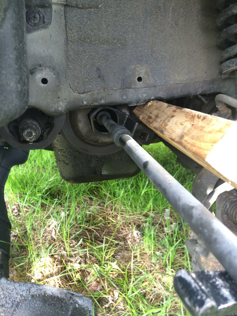

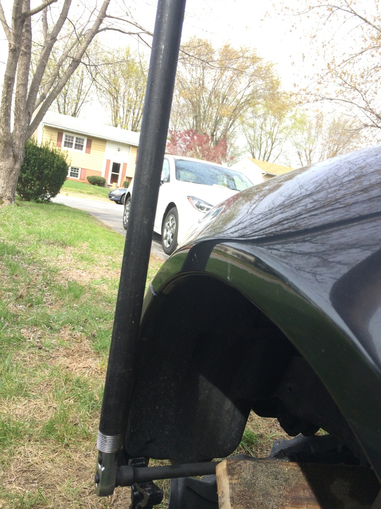

Buy the pulley holder tool, among with a 6ft piece of pipe. Use impact sockets and extensions. Set up like this:
