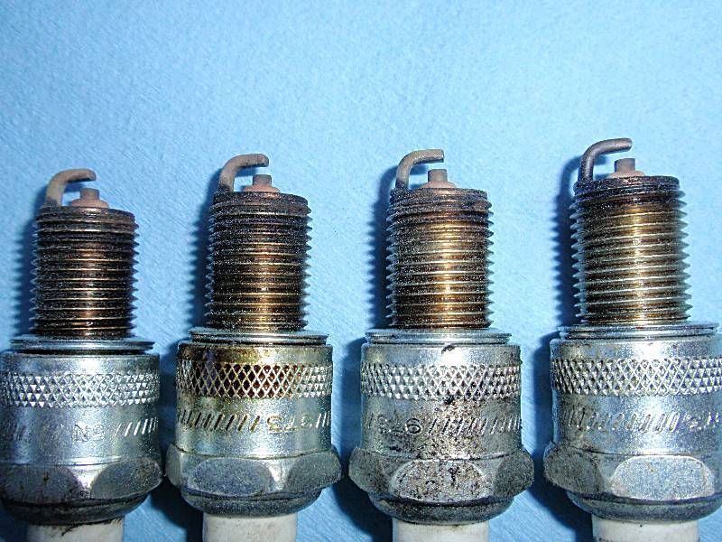

Ok, I think the valve adjust section of my shop manual will help me find TDC on all the cylinders. I got the oil and filter changed today, and pulled out the sparkplugs.
Not sure if it shows on the picture, but there looks to be a bit of powdering on the electrodes. Might mean some coolant contamination, I think.
