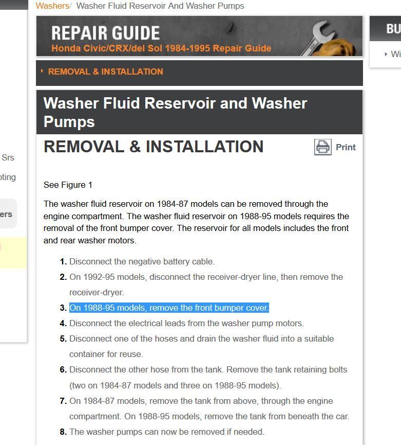

HI I'm trying to get my windshield washer reservoir out but i'm stuck on the last, most central bolt. Do I need to take the bumper or headlight or other piece out first?

the replacement guide on autozone website says the bumper needs to come off. from what i remember the bumper was really quick to remove, a couple bolts hidden behind lights on the bumper, no?

Hey thanks RobertD for the prompt reply and for the link to the auto zone repair guides. I'm new to old Hondas. Do you recommend any particular other online manuals/guides? Victor
