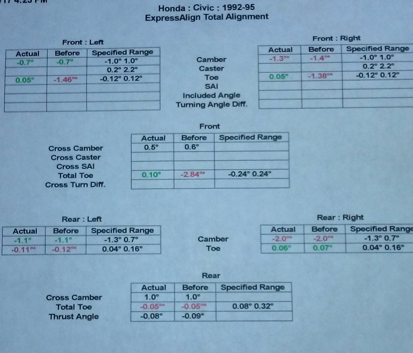

Alignment performed today at Firestone..image attached. No time to check on level road yet ..went from Firestone to work but, seems good. Probably need to adjust tensioner a bit to lessen wheel play. The tech said he had to turn the passsenger side outer tie rod inward (he didn't count turns) so, hopefully the turns on both sides are equal or close to eqaul now.

Re: De-powering Steering Rack
WHY no caster readings? Too lazy?
At any rate, caster should still be the same as before, and pull won't be any different. Centering hopefully is correct now though.
If # of threads exposed aren't scary then don't worry about it.
I see rear toe this time.....and left rear toe is pointed out. It's adjustable (if it's not seized up), so......Too lazy, couldn't be bothered?
*eye roll*
Can't change the rear camber without parts or work....

Compare this printout to the printout you got from Firetire. Nobody touched anything between those two shops, so why are toe readings so vastly different?
And all are different from the first one posted
Alignment results..given by phone.
Front:
Camber: Left 0.6 Right 1.4
(NOW I realize both of these were actually negative)
Caster: Left 0.3 Right: 0.8
Toe: Left 0.07 Right: 0.04
Rear:
Camber: Left -1.2 Right -2.0
Cambers are all about the same, untouched. Ok.
Casters....odd that the RF is different # from one printout to the next yet appears to be unchanged (RF caster says -.9 on the most recent printout just looks wrong)
Toes are all over the map.
FWIW I prefer reading the printout version you got from Firetire. All of these alignment machines can print whatever version the workerbee wants to print....or the ONE version they learned how to print.
Still nobody can take the SAI/IA readings? FFS it's like one extra step with the initial caster check.

BTW it's really hard to tell where it's at as it stands because you have 3 prints that disagree....or are woefully incomplete.
If I see a print that says (front is) this:
Camber: Left -0.6 Right -1.4
Caster: Left +0.3 Right: +0.8
This car would be likely to pull LEFT on flat ground. Let go of the wheel and it would eventually head for oncoming traffic.
If the right caster number were changed to -0.9 (todays printout number), I'd expect the car would pull right. To the ditch.
If -0.9 were true and accurate, I bet you would probably be able to see/feel a noticeable difference in the setback of the front wheels. The one at -0.9 would probably be pushed rearward...Comparing sides, a finger width of difference or more, when palming or fingering between the tire and the wheelwell lip
