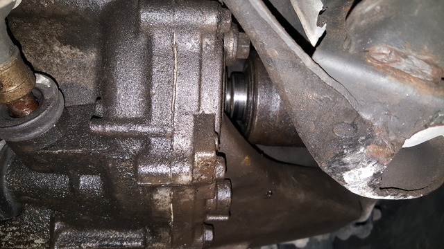

Installer error:
Did someone pull the axle shaft out of the inboard CV joint causing the rollers to drop into the rubber boot?
