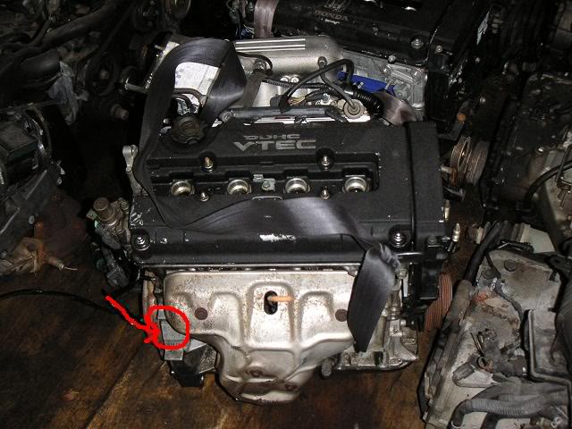

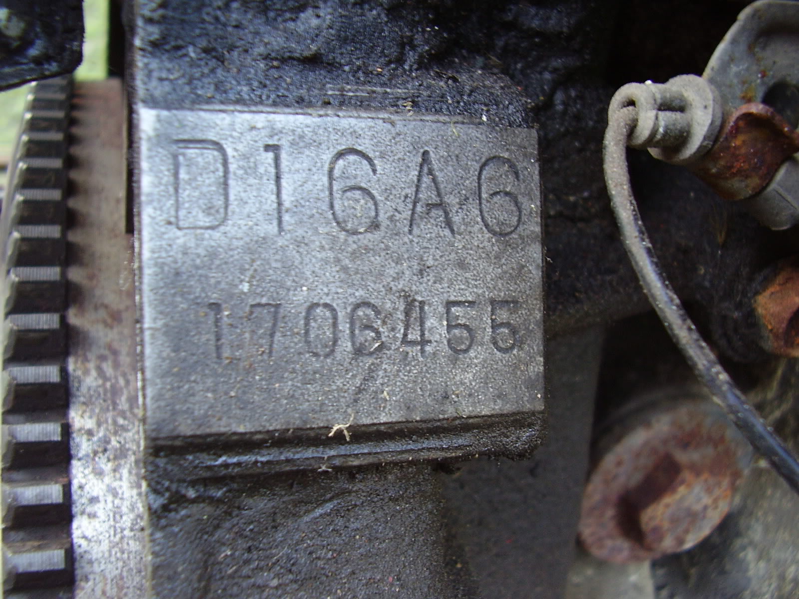

I need to be able to ID the engine.
Honda generally puts the numbers on a flat pad here
