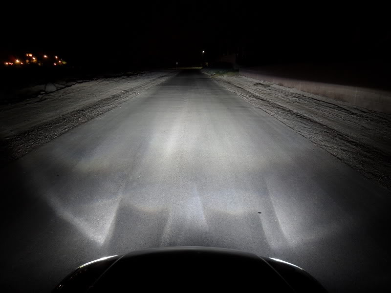

Case in point, here's a direct comparison pic of PnP HIDs in aftermarket housings vs a TSX retrofit into the same exact headlight assemblies. This is a pic I personally took of my own HID setup's output, after I had swapped one headlight for the TSX retrofit, yet the other was still the crap PnP into TYC housings. Mind you, the PnP beam, I finagled a bit with the shield to get that nice cutoff.
Top beam is H1 HID bulbs in TYC projector headlights.
Bottom beam is D2S HID bulbs with TSX HID projectors in a TYC projector headlight assembly.
notice the splotchy light output of the TYC projector, and the nice, even light pattern of the TSX HID projector. The TSX projector also has a much cleaner cutoff line than the TYC ones do.
Edit1: I dug around some old photos I had, and found a light output comparison of the two, at similar angles.
PnP in TYC housings:
TSX Retro in TYC housings:

FIgured I'd share this highly relevant image.
You'd be looking at $249 shipped for a morimoto mini d2s retrofit kit to go in your OEM headlights.
Just to recap, what the kit would include:
-Morimoto Mini D2S V4.0
-Shrouds of your choice (there are a couple that make it cheaper or more expensive)
-Morimoto XB ballasts, your choice of 35W (standard) or high powered 50W (run hotter, color is more washed out, but much brighter)
-Morimoto XB D2S bulbs, choice of color (3800k, 4500k, 5500k, 6500K; I'd recommend 4500 or 5500K)
-Relay harness for H4 OE equipped cars (e.g. your civic)
-Headlight sealant
A smidge more if you want LED halos.
edit #(I lost count):
Modification may be (highly likely will be) required to fit the shrouds in the reflector bowl. I have Gatling Gun 2.0 shrouds and I had to take about an inch off the backside and sand down the bottom of the shroud to fit. You can't tell at all that I shaved them down.
