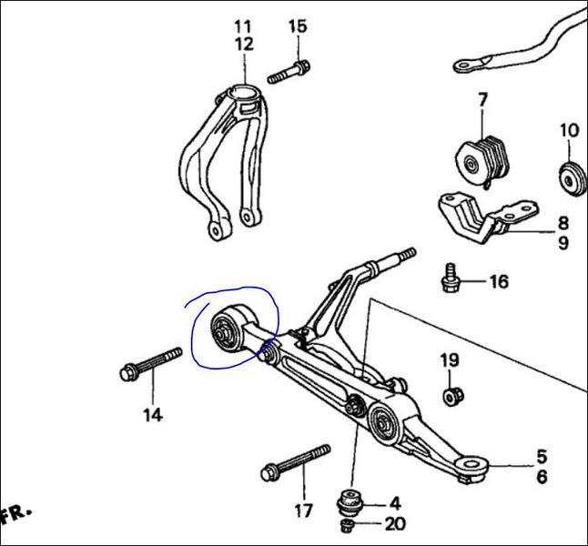

hey gang - 97 Civic EX (2dr). I'm trying to tackle a clunking issue that's been intermittent and yet driving me insane. Going to start at the front suspension and just work my way to the back. Been spending the past few hours researching this site for various how-to's and the help has been great so far.
I just need help identifying a part number. On the LCA arm there is a bushing in the back that I can't find online, nor does is seem to be labeled on any honda parts diagrams I'm looking through. See blue circle in attached pic. Can anyone assist me in finding this? THANK YOU!

Factory says you buy the complete arm to get that bushing.
(Also FYI, factory says to never take apart the halves of the LCA.)
I have no idea if aftermarket sells that bushing separately.
HTH
