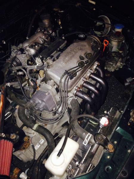

The headers have a spot for the o2 sensor I believe. It's a bolt that is plugged up. Trying to figure out how to attach images lol

Old Aug 29, 2014

The connectors for the 2 original oxygen sensors should have been right below the upper radiator hose...and I can't see them in the pic.
Are there any o2 sensors on that exhaust anywhere? Under the car?

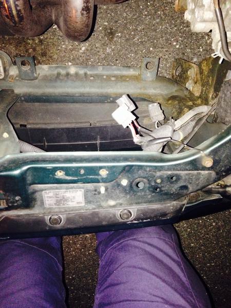

There is connectors with nothing plugged into them right behind grille in engine bay. I'm not sure if there is a second o2 sensor. Car is lowered so I will have to figure out a way to get under there to see. But now that you mention the plugs and me seeing there is nothing in them then I doubt there is
Old Aug 29, 2014
Rep Power: 518
Re: ECU head scratcher
^That kinda looks like it would have been for the AC and condenser and fan parts that got removed -- because race car!

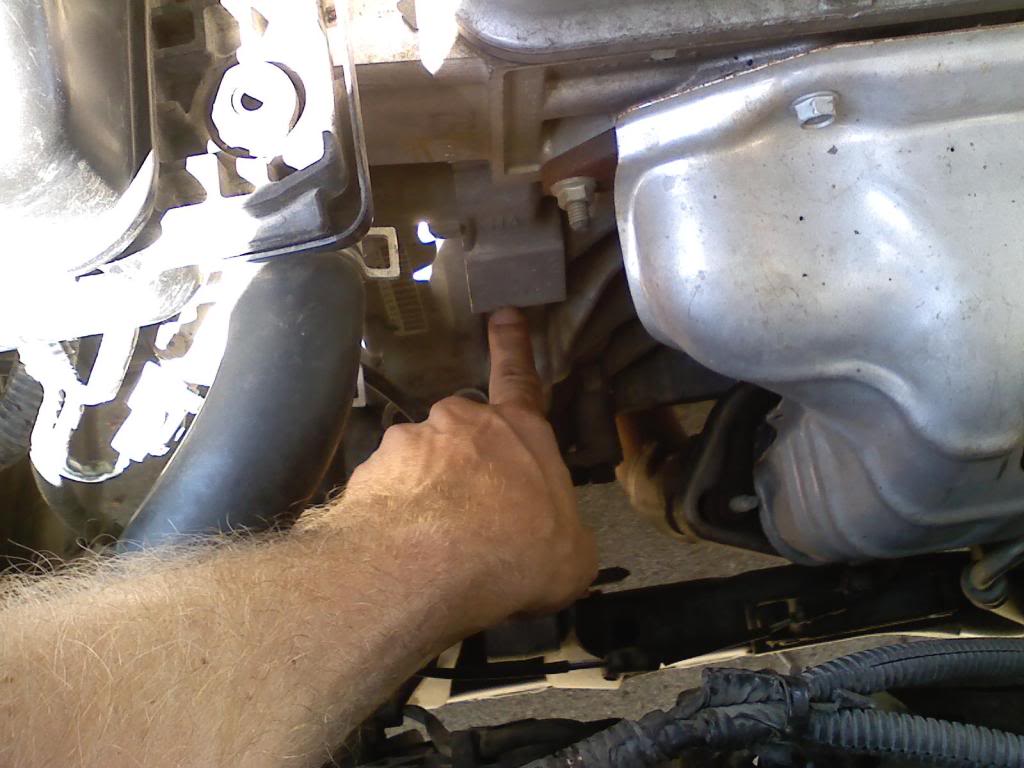

http://mattgadient.com/2013/03/13/re...-and-pictures/
Your connector should be the yellow circle in the pic.

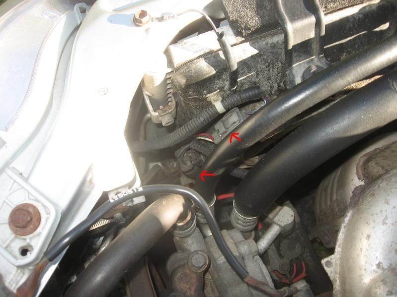

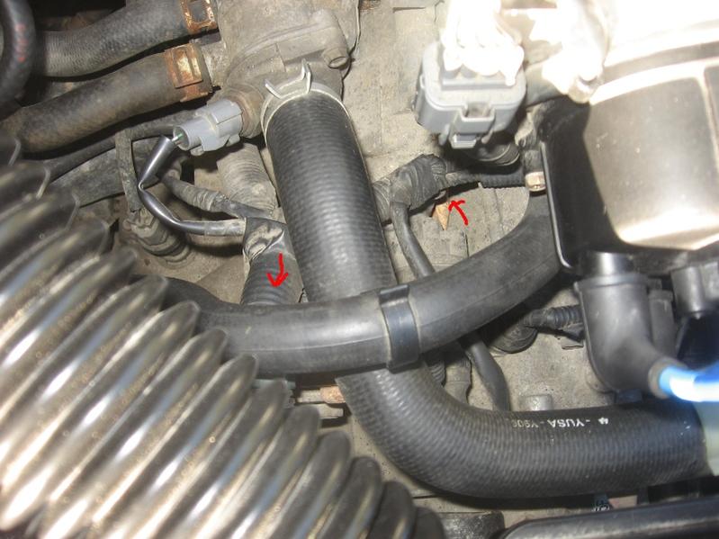

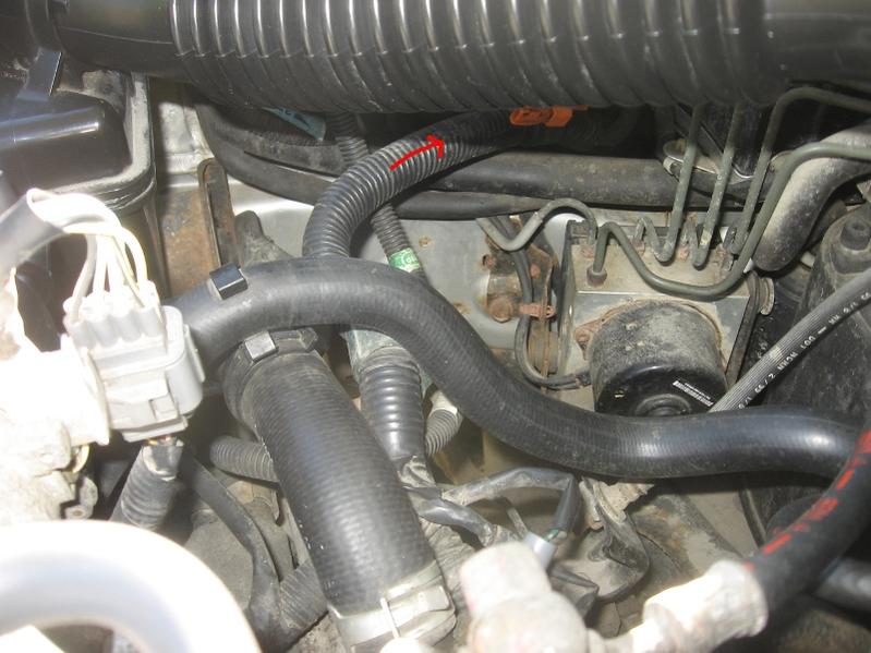

The pics trace back from the O2 sensors back into the main harness before it enters the firewall. Those connectors by the drivers side headlight are for your missing AC.
