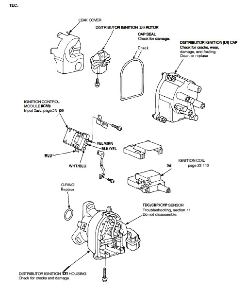

id check ur ignitor. not sure of what the resistense ohms are supposed to be.
