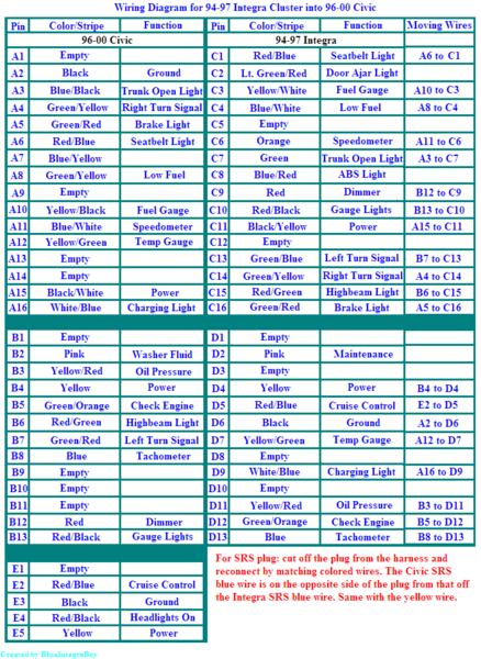

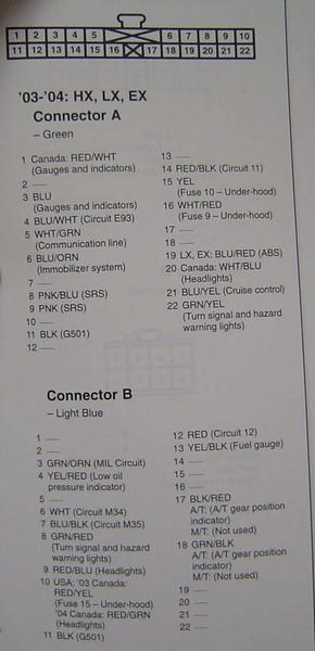

Ok, so Im not too sure if this is going to work judging by the wiring diagram. The only gauge that it shows by itself on the 03 is the gas gauge. Im not sure what some of these wires mean that just say fuse and all that but by the looks of it, this wont work but someone please correct me.

Alright, I went in today and tryed one last thing. I have turn signals working, gauge lights, fuel gauges, tach., The only problem I have now is the spedometer and the temp and odometer(havant messed with it yet so it might not be a problem). Anyway the wire on the 03 cluster they all go into is the same color. All the gauges hook into it, it seems. What can I do about this?
