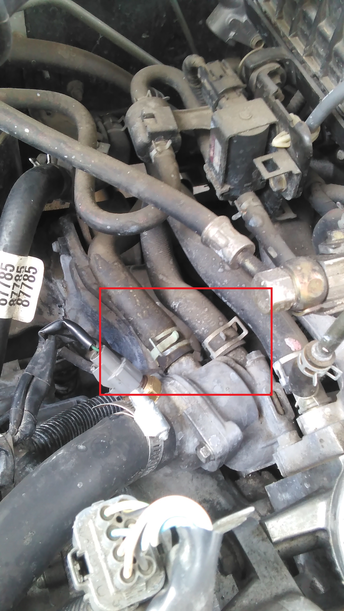

What hoses are these?

I found the bypass hose. I can't find the one next to it.
#3 = bypass hose. Maybe I can go aftermarket.

The one that makes a U shape serves as the bypass hose.
The other is a heater hose.

You already had the link with the U shaped hose, this one should have the rest of the heater hoses
