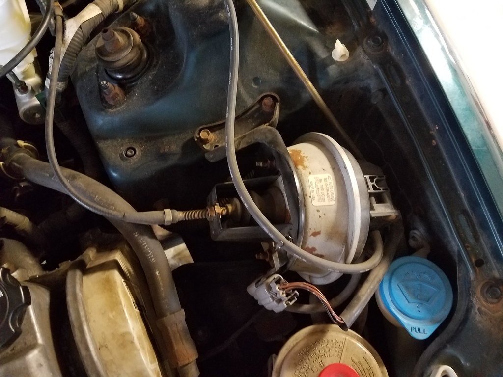

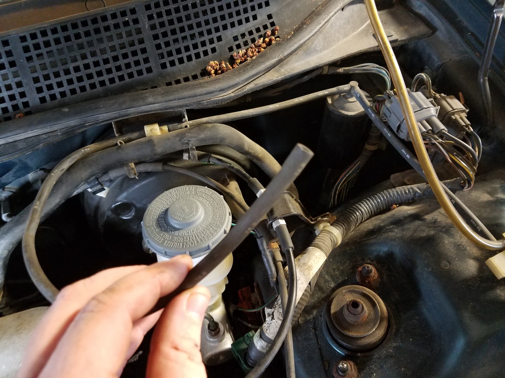

hey guys sorry to make another post but just trying to keep things orginized in the forums if anybody tries to search for the same topic but i was working on the car again and found a cut line that looks like its coming from the cruise control system it looks like a vacuum line:

That should connect to the intake manifold. See any open/capped off ports that line would reach? Or do you have one of those fancy intake manifolds that the cool kids put on and there isn't any available port. It could be disconnected on purpose because it's faulty.

I think it's on the back side of intake manifold, runner for #1 cylinder, points toward firewall.
Listen closely for the light hiss sound from that area while it's idling.

well i found the port that the vacuum line connects too and as soon as i hooked it up the motor bogged down so bad i thought it was going to kill itself maybe idling around 500rpm or lower. i checked the check valve before the canister and its working just fine so i don't know whats going on.
Old Mar 19, 2017
Re: cut line on cruise control
The computer learned how to idle the engine with a vacuum leak.. Now it has to learn how to idle all over again without a vacuum leak.
Try doing an idle relearn.
