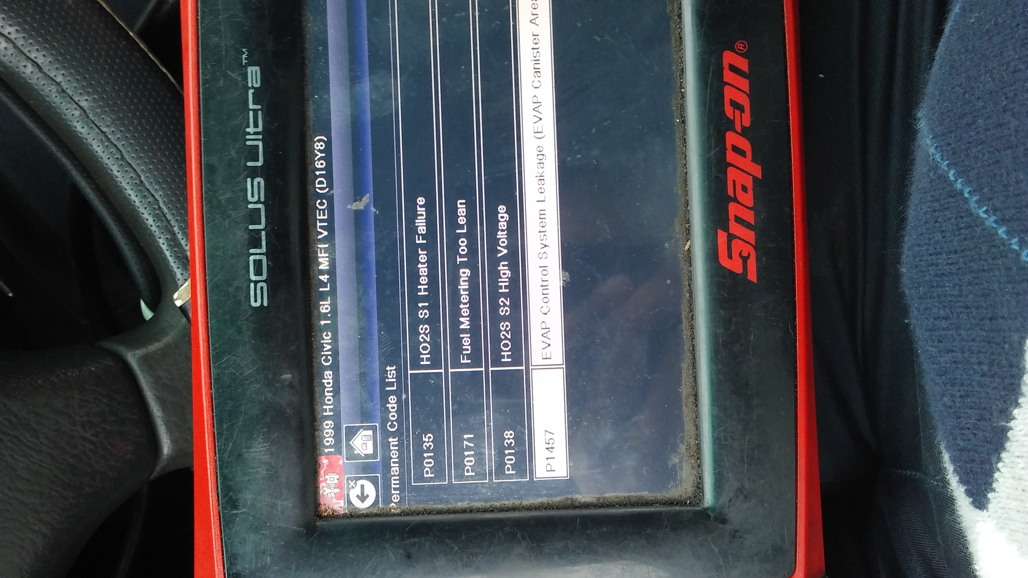

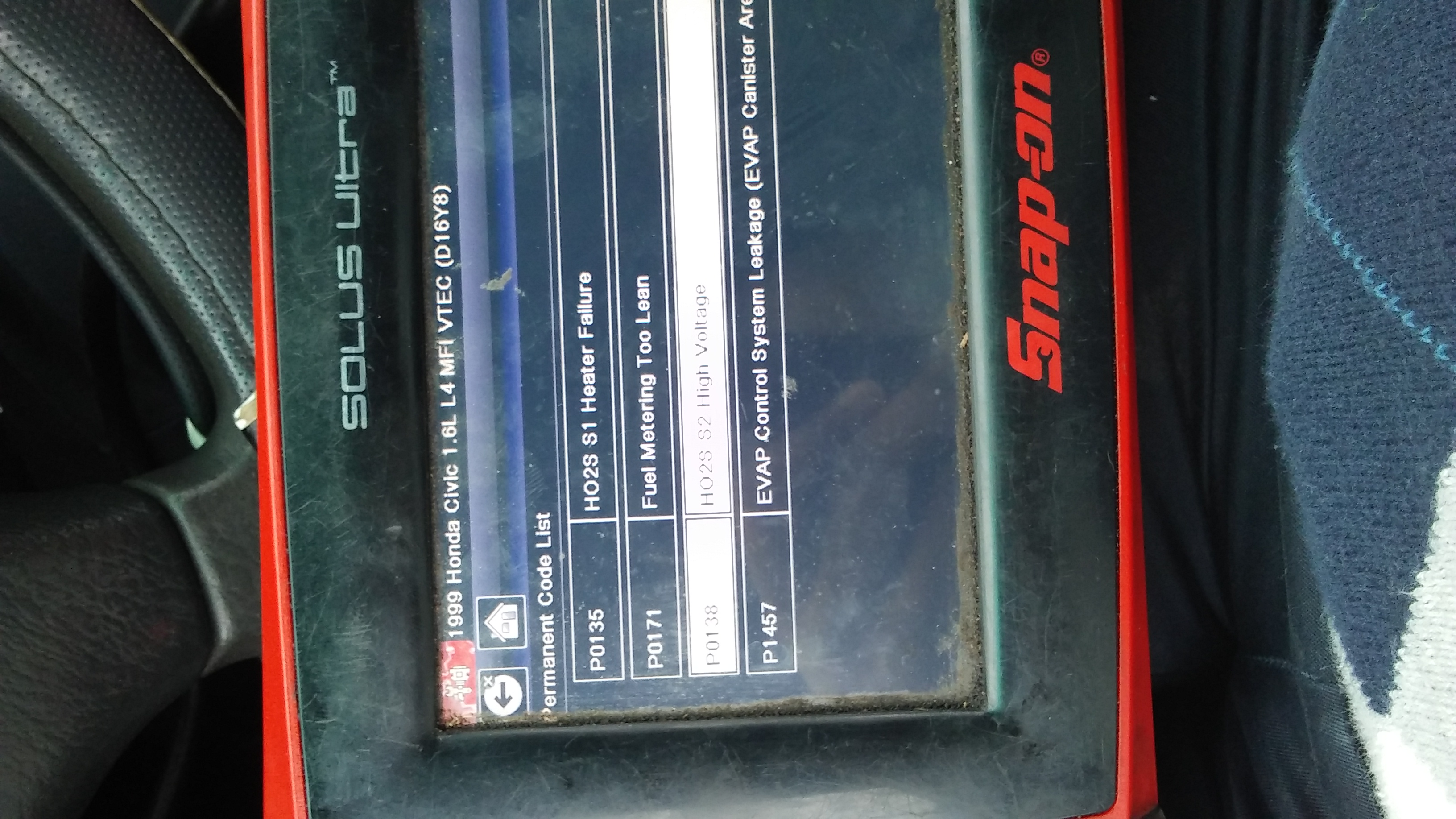

heres the codes

Old Mar 22, 2017
Re: Multiple Codes S.O.S. 6th gen civic
Hey, that looks like a pretty nice scanner.
Did you write down the freeze frame data to go along with one of those codes?
I'd go after the O2 sensor codes first.
Ignore the P0171 until the sensors are fixed, then see if it returns.
The P1457 code may require real work. Does that scanner support bi-directional controls, and can it force an EVAP system self test to run?
I'd first see if the ECM is capable of turning on the bypass solenoid. If not, refer to the service bulletin about Bypass solenoid valve failure (internally shorted) for further info.
