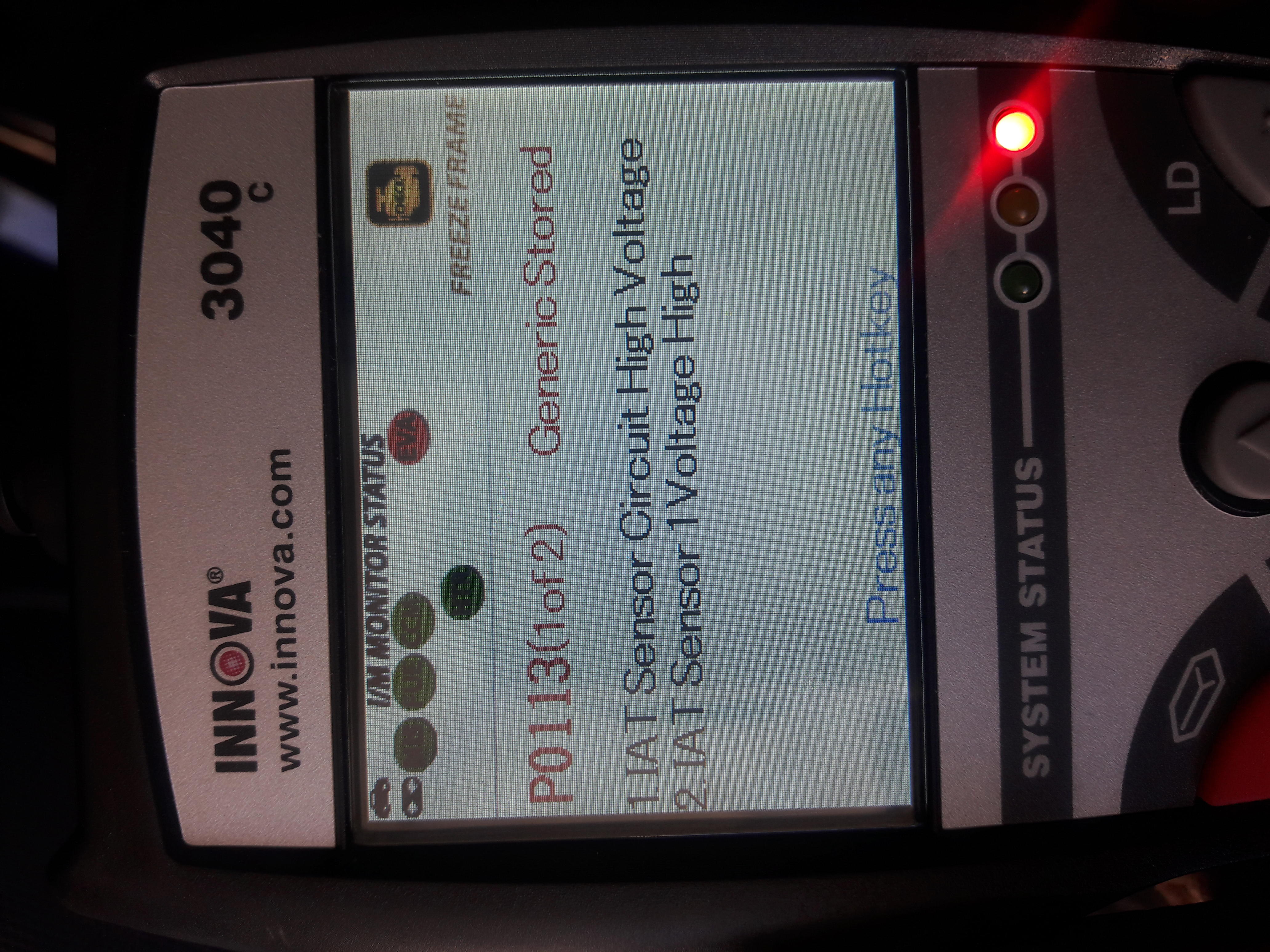

Car has been running good after the whole idle issue....now this am I start it up since its been sitting a good 3 days....right away pop a code p0133 I think. High output...now thr only thing that's been touch on thr intake was re attaching a wire to the air sensor going into air intake...possible they are switched? Want to fix it right previous owner had it tucked.. sorry about the quick post and the bad picture quality I'm currently working on the car on my cell phone

Okay so I switch the wires around because I did not know which one was positive which one was negative started the car up put the scanner on and now I'm throwing a code for the exact opposite now it's low voltage to the IAT.. rpms dropped to 800s however and sounds better...
Thoughts. Whatever numbers you need I can them

IAt sensor shouldn't be polarity sensitive. I'm thinking you may have wire terminals not in the original connector shell (or bare wires?), your high code is from an open circuit, and the low code is from shorting the terminals together.
Can that tool display the actual temperature value?
IAT TEMP 419.0
TPS 9.4
Rpm 871
MAP 8.6
Been idling for 5 min or so going around block

IAT TEMP 419.0
Looks like the temp value of a dead short between the two wires.
If the sensor is unplugged the scanner would probably say -40*
