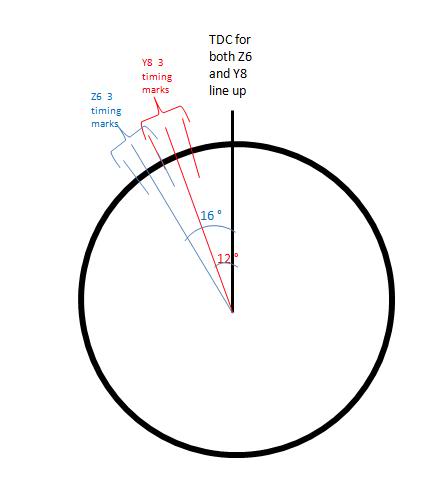

Old Feb 5, 2017
Re: Timing Belt
Set crank to true TDC.
That's the single lone mark on the harmonic balancer, not the triple notches.
Set cam gear to its timing marks per instructions.
Install belt per instructions. Sometimes something has to move just slightly in order to get the belt on and the crank moves easier than the cam gear.
If you get it together and still think it's a tooth out of time, take belt off and move it one tooth then recheck.
If the timing belt is one tooth off, your mechanical timing will be somewhere around 10-20 degrees off, and that might be the ignition timing (triple) marks.
If the belt is installed correctly and you've rotated the crankshaft several times, set the your crank pulley aligned to the pointer exactly on the single notch perfect and true (TDC) -- your cam gear should be within a few millimeters of perfect. (much less than the space between two timing belt teeth)
Which engine does the car have?
