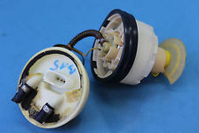

I recently helped my friend with his 2004 VW Passat (B5.5) 6 cylinder 2.8L.
It has a crank but no start issue. On his own he checked the fuel pump (beneath back seat and door accessable). He said he can hear it prime and he removed it and tested it with a 12v source and it pumped. I checked spark and all coils/plugs are working very well. Air filter is clean, TB is clean. I did a compression test with all plugs removed and could smell gas. We removed fuel lines where they attach to the fuel rail, cranked engine and no fuel seen.
Side note: fuel rail has a pressure regulator. Spark plugs were not fouled, weren't wet and normal appearance.
He said the pump is under the backseat and the float is further back.
Is it possible to have a fully clogged fuel fiter (underneath car between fuel pump and engine)?
Could it be that the pump is working but has very weak fuel pressure?
Possible tear in internal fuel pump hose (shown in pics)? Related thread: http://www.passatworld.com/forums/b5...em-b5-5-a.html
Yes to all, and each could be diagnosed...checked if good or bad...
Got a pressure gauge?
Back in my Audi days of long ago....their fuel pumps were LOUD. If you heard a pump that was too quiet and the engine didn't run, it was probably out of gas LOL
Will the engine fire up on carb spray?

Thanks Ezone. Yes I have a FP gauge and I hooked it up just before the fuel rail and it read zero pressure. Removed it, held bucket to catch fuel and no gas at all in both fuel lines when cranking engine
I didn't try carb spray.
The TB is facing and about 5 inches from firewall..makes it tough to clean without removing it.
He's said he's going to change the fuel filter and inspect the internal, accordion style hose on the fuel pump sometime this weekend. Used pumps are only $20 at local U-pull junkyard or $35 already pulled so it should be a cheap fix..hopefully.

One post says the pump did move fluid when ran manually? Put the pressure gauge directly on the outlet that would be on top of the tank, see if the pump can build good pressure right there, or if it pees out the side of a split hose.
If it can build pressure then move up the system, if it has an inline filter check there next.
Crushed line under the body from an impact?
