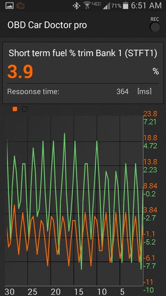

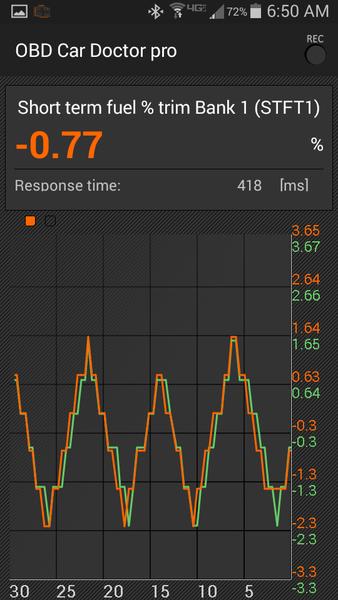

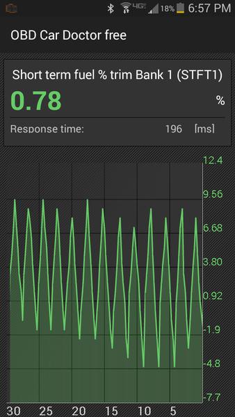

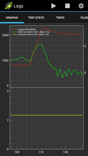

I am still having very poor gas mileage and am trying to figure out what the graphs mean as to what the problem might be with my car.
I have been watching videos to learn about STFT and LTFT but am confused with the mapping of the graphs.
My car was getting 28-30 mpg but now is getting 23 mpg or less.
Can someone explain these graphs to me?

STFT .78? I can't tell how much of the time it's in that range, it looks like it nears 0 part of the time. Describe more?
LTFT looks in a normal range, less than 10% is good.
What front O2 sensor is? Original? Replacement? OEM?

If I put the engine in park and idle it and then Rev and hold the rpms around 1500 - 2000 the STFT goes up but spikes like you see in the graphs. Up and down and up and down. If I drive it, the STFT fuel curve goes up with engine speed but still spiking to some degree. It's not a smooth curve. I was thinking that it might be a fuel delivery problem from the videos I've been watching but the spikes are throwing me off. Wondering if it might be a vacuum leak? There is no CEL. I have no idea. And am kind of scared of doing the whole spray stuff around the engine bay to see if there is a leak.
Old Apr 9, 2015
Rep Power: 518
Re: Short Term Fuel Trim Question
STFT should change rapidly and often, technically it is changing with every transition of the front O2 sensor.
If you graph the front O2 sensor along with the STFT you may see more of this.
Hot engine:
What is STFT -- idling in neutral? (rough average number)
What is STFT -- idling in drive?
What is STFT -- at 2000 RPM in neutral?
What is the LTFT range under all these conditions?
With fuel trims, base calculation without correction is 0 (%). This is calculated from temperatures, load (MAP in this case), and RPM inputs.
Corrections to fuel trims come in when O2 sensors are read and used for additional calculation. The sensors are the "feedback" the computer is looking at to measure the oxygen content in the exhaust.
(Your .78 number is the equivalent of -22% STFT, which would be removing fuel from the base calculation. Computer thinks system is too rich and is removing fuel.)

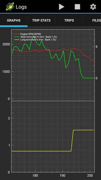

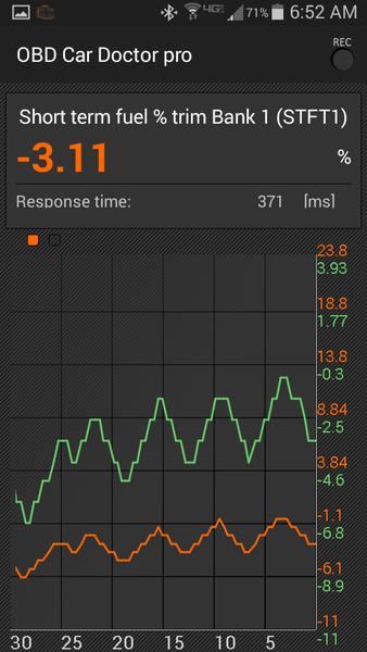

Okay got some more graphs/readings from under the conditions you asked about.
STFT
Idle in Park is reading in range of
-1.49%
-0.69%
-2.29%
STFT
Idle in Drive
-0.77%
-1.55%
-0.78%
STFT
Neutral @ 2000 RPMs
-3.11%
-4.67%
2.34%
-2.33%
-7.02%
3.9%
LTFT
Park
Neutral
Drive
All average out at -0.78% to -0.77%
Graphs to follow (graphs are showing correlation between stft and bank 1 sensor 1 %)

I think I may be confused as to how your app works.
I may have interpreted your .78 as lambda instead of %, or based the starting point as 1.00 instead of zero.
There are several different ways of reading trim values.
Anything within 10% fuel trim correction is usually OK.
Codes don't start happening until you hit the 20% correction range.

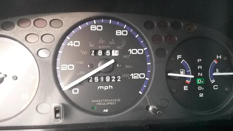

I have no idea how it was moved or why. There was a white line drawn on top to line it up. Anyway it worked cause my car is shifting perfectly, is full of pep and is back to its normal gas mileage. It's sad I spent all that money on tune up and other parts when I should have taken it to this shop first. But I never know which shop is gonna find the problem. Either way I'm estatic to have my good gas mileage back. Thanks for all the input.
