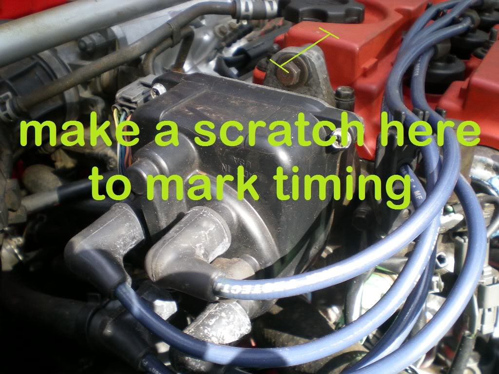

I make a reference mark from the body of the dist to a point on the head area so I can reinstall it exactly as it was before, see this pic:
Mark doesn't have to be exactly as in the pic, just somewhere so you can get it back on in the exact same position it came off.
If you pull it out without marking it, you will need to find a timing light to set ignition timing.
