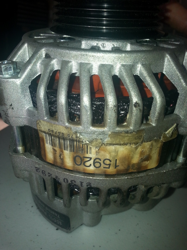

A week later, all of a sudden I smell a real nasty smell and notice that my battery lights and others start coming on in my cluster. I make it to my friends house where we look under the hood. The alternator had literally like cooked and the inside windings were all black (you could see where the varnish was like melting off the wires). The car wouldn't start again because the alternator wasn't charging the battery anymore and so it was dead. So we took it back to Oreilly, and of course since it's a life time waranty they were going to give me another rebuilt unit. So I ask them first to test the "new" one on the test bench to be sure, they do, and sure enough it fails immediately. So we end up going over to another Oreilly store nearby since the store we were at didn't have any more. We pick up the new one and I install it. Car runs ok, but the voltage is kind of low.
Here's a nice pic for you of the burned up rebuild one:
