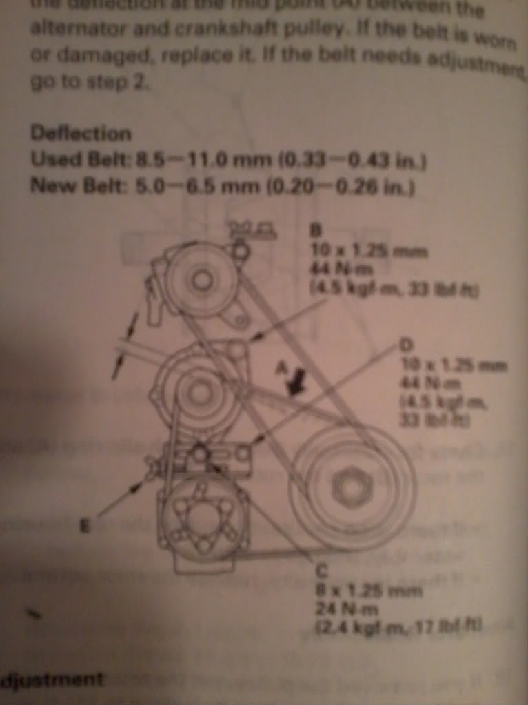

1. No, but I would imagine at least $200.
2. Doesn't include the timing belt. Accessories are A/C compressor, alternator, and power steering pump from bottom to top:
At point A the deflection should be as described at the top. Deflection is the movement perpendicular to the movement of the the belt- how far it moves up and down while it's rotating around. Should be able to loosen B and C and take a pry bar and hold the belt tight with the alternator while tightening those bolts.
-You'll have to move the PS pump out of the way to work from the top.
-I've sometimes found it easier to take the plastic inner fender out and work it from there.
