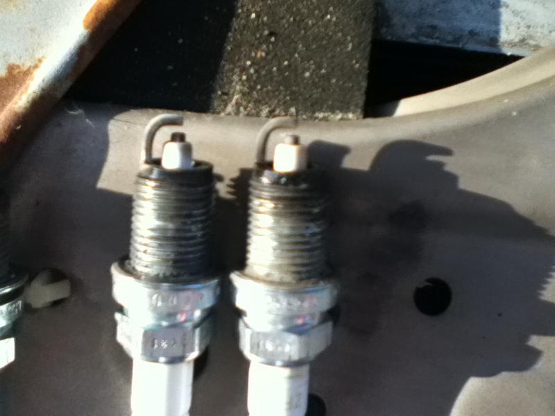

Well, I switched to a new Honda radiator cap and thermostat. Still bubbling away. I took the plugs out again. The #1 plug looks slighly different than the other three. It's hard to tell from the pictures, but there's more oily residue on the end of the threads than the other three. Overall, I'd say they look pretty good.

Re: 2000 LX - Bubbles in Coolant
I just had this happen to me. it would do this every now and again for a couple weeks. Your head gasket is starting to go bad. Once myn misfired on 3 cylinders and it was water in it. about a week later there was no circulation. bad head gasket but if your a mechanic, get on rockauto . com and they have rediculously low prices on everything. i got my headgasket set for like 50 bucks shipped
