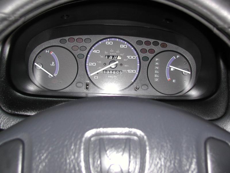

Hi,
I've noticed that my speedo reads about 7% faster than my actual speed. I checked the site below for expected differential due to tires changing from 185 65 R14's to 205 40 R17's and there's practically no change.
Speedometer Calibration Calculator And Information
http://www.csgnetwork.com/speedocalibcalc.html
I contacted a speedo shop here locally and when I told him I had a 2000 Civic Dx Coupe with an analog gauge, he said nothing can be done to calibrate it and that that is the problem with Japanese cars, they all do that. He then referred me to the dealer.
Personally, I think he's full of it because I've had several other Toyota's and Honda's and have never had this problem. Perhaps I should have have pointed out that although it's an analog gauge, the system is electronic, deeming it adjustable/repairable.
Any input on this would be appreciated.
Thanks
Selvan

I have a portable GPS unit in my 04, and find that the speedo and actual speed as reported by the GPS is very, very close. Is that how you know your speedo is off? If not, how did you determine the 7% difference?

Hi and thanks for the input, it does help.
There's major freeway constructions going on around here and they've put up those radar signs that show your speed on both sides of the freeway. To check their accuracy, I drove by them in another vehicle and both radar signs were right on.
