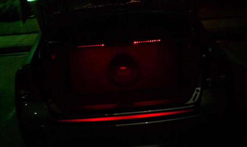

do they come in red
Old Sep 26, 2011
geopatton3's Avatar
Joined: Sep 2011
Posts: 9
geopatton3 is an unknown quantity at this point
Re: LED Dome, Map, Licence, Trunk Conversion [Pic Heavy]
I have red all in my car, was wondering if they come in red
