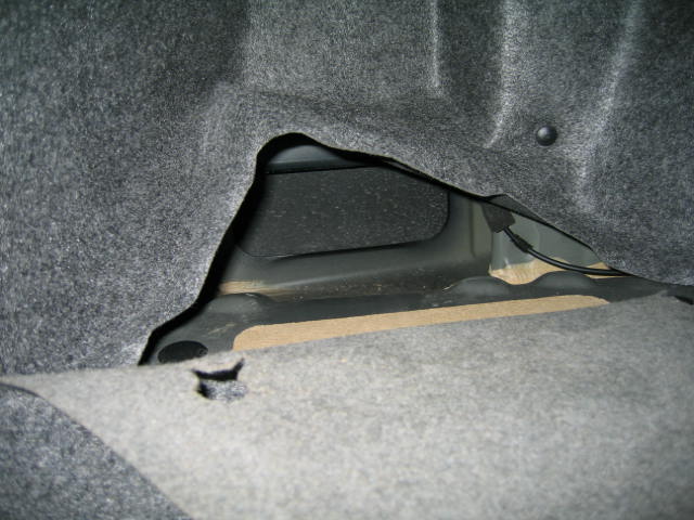

This is the area where you will find the vent flap. Lift up the carpet as shown and you will see a black box with four clips. Two on top and two on the bottom. Just pop the bottom ones out toward the rear bumper and it should fall off.

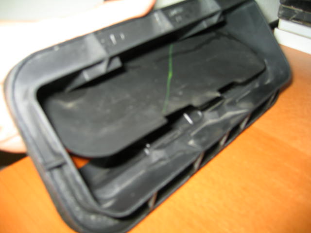

vent facing out and under the bumper.

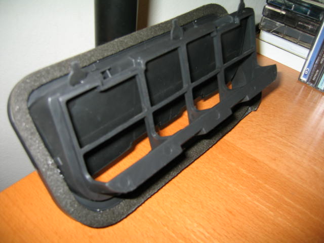

flap lifted.

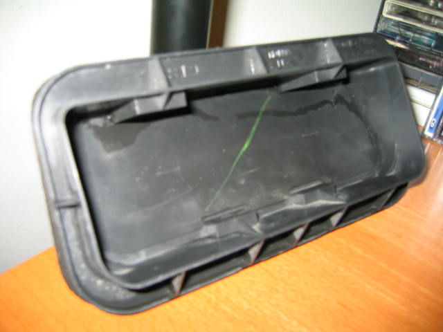

back of the vent, the part that you see from inside of your trunk.
