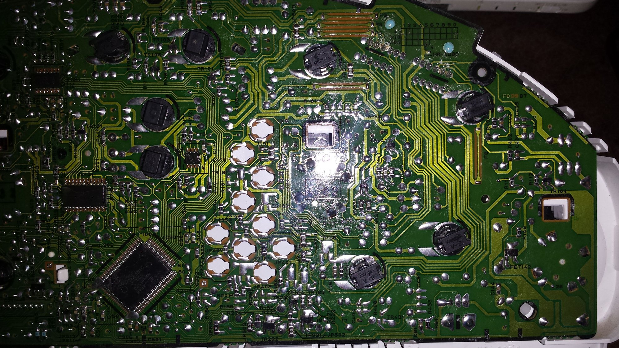

Id check the cluster circ board bulb base contact pads for powers and grounds.....maybe if something is missing follow the traces to see if a trace burned out

i assume all these missing ones are just for the automatics.. the top where the connector plugs in you can see the flux is flaking..
its weird cuz the odometer LCD is on the complete other side and is dead also
Ya that's weird....but is just the green coating missing--- or are the conductive traces broken?
With lots of zoom it looks like the green coating is missing between some of the conductive traces....but over at the main connector it looks like there's some whitish powder or corrosion?
Can you follow the traces to see where they start or end?
Shine a flashlight through the holes and check out what lights on the front
The numbers looking screwy with age seems kinda typical.
You could remove (twist out) the main illumination bulbs and ohm check for continuity between the board contacts (they all share power source and ground source) so you could tell if there's a broken connection between any of the sockets
(I can't tell from a diagram exactly how many are for illumination but you could probably take it into a dark area and shine a bright light through the holes to find out)
