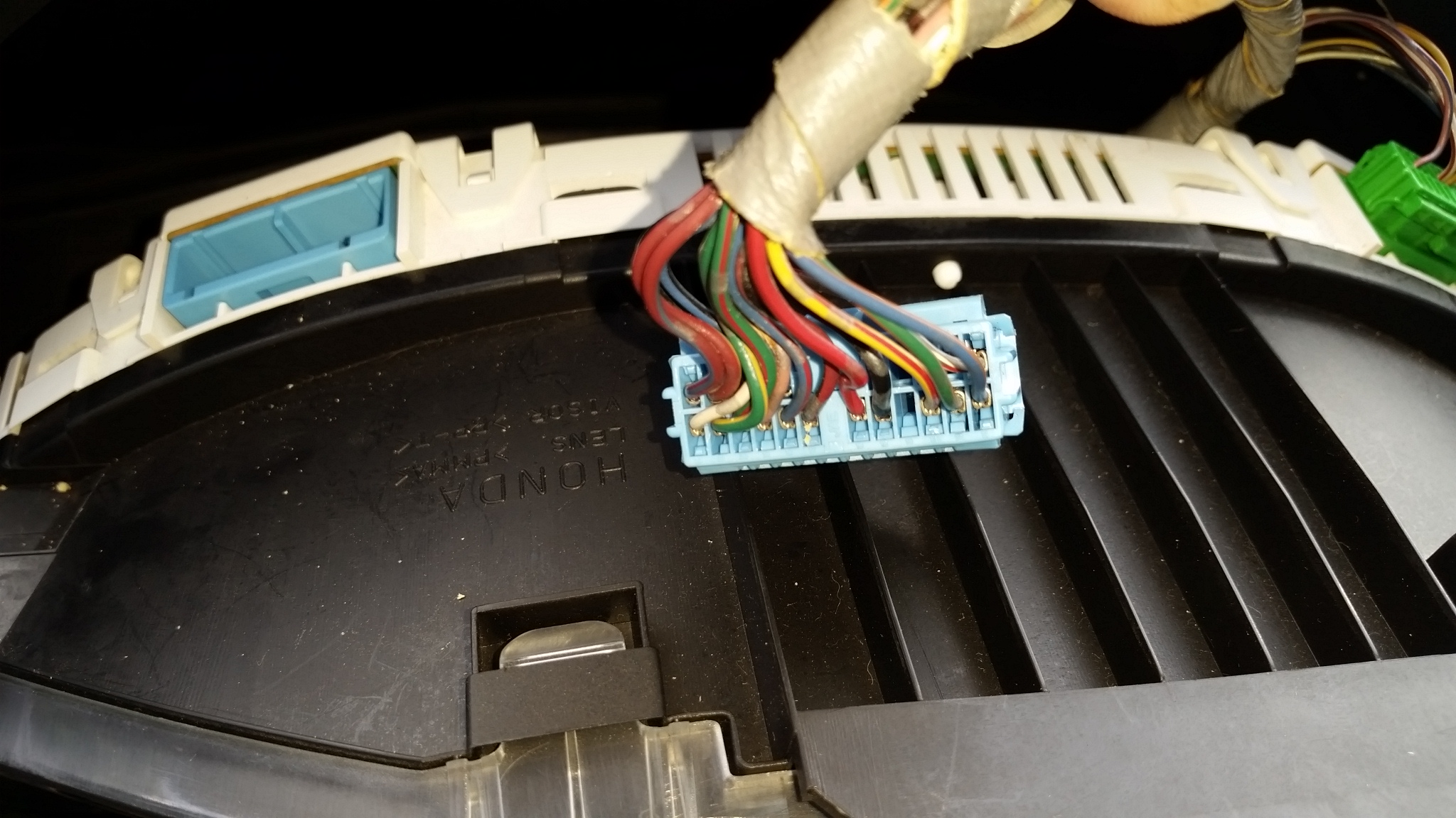

Old Jun 14, 2017

Old Jun 14, 2017

Re: CEL wont come on
Size:  678.2 KBthe green orange wire is the second from the right on the bottom
Last edited by Atriticuss; Jun 14, 2017 at 05:14 PM. Reason: Double posted picture
Old Jun 14, 2017
Then i probed E24 yellow, which i think is the right one to send the signal
Um, that's a data line for communication between the PCM and MICU. Boy, I hope you didn't hurt anything there...... that circuit is included in the transmission range (PRNDL) indicator schematic .
I suppose you've tried grounding that terminal directly to try to make the CEL turn on?
