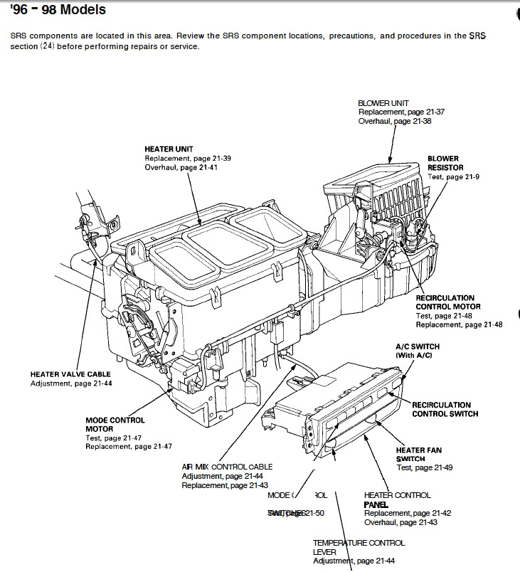

I'm not sure for a 7th gen. On a 6th gen it's located on driver's side as shown in attached pic (Mode Control Motor). Search Google for 7th gen diagram or just look on your car for the mode control motor location shown in diagram below.

I checked the plug that goes into the mode control motor(MCM) and it has 5 volts on a few pins but none on the outer ones and when i change the **** the power does not change. so no power to the motor then its not going to work. Is there a relay for the MCM?
The Main problem is the recirculation motor. that doesn't work either.
I just want the outside intake closed. If i remover the motor a little and manually close the vent and put the motor back will it stay closed?
Just don't want exhaust inside the car.
